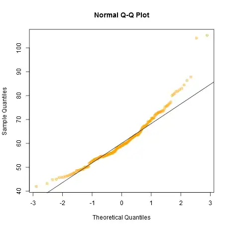

The following is an example from OpenIntro Statistics textbook
Let's have a look at this Q-Q Plot:
qq1

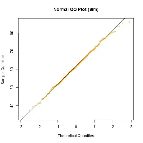

Is it normal? Let's compare it with normally distributed data:
qq2
This one looks better than our data, so our data doesn't seem normal. Let's make sure by simulating it several times and plotting side-by-side
qq3
So our gut feeling tells us that the sample is not likely to be distributed normally.
