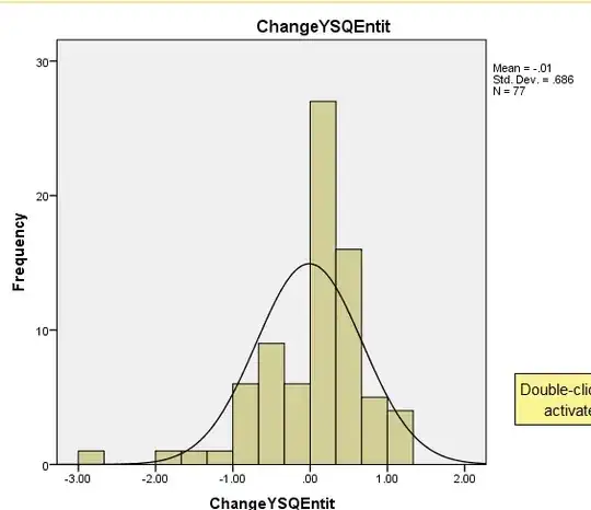

I have a sample of n=77 change over time scores (T2-T1). In a lot of cases a score of 0 (no change over time) is modal, at times 33% of the sample. I am wondering if this impacts the assumption of normality at all, due to the high frequency, compared to other scores.enter image description here I should note that when I make the bins smaller, there is still one response that remains the mode by quite a bit.
Here is another screenshot where there may or may/not be left skew enter image description here. It is difficult to tell with that mode and a single extreme value. I have avoided doing statistical tests of normality as I hear they can be very sensitive, and I'd prefer to use parametric tests if possible.

I will assume you ask about the normality of your change scores. About how to analyze such data. You could do much better than just plotting a histogram, which will depend on the binning. See here: Is there a rule of thumb to choose a normality test?
Other graphical methods is qqplot Interpreting QQplot - Is there any rule of thumb to decide for non-normality? which you could try. And, if there really is an appreciable number of exact zeros in your differences, you should investigate why. But maybe it is just about binning.
