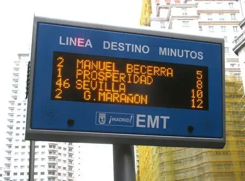

Electronic displays with a fixed height tend to omit the accents altogether (e.g. older displays in trains, the metro, buses, bus stops):
PRÓXIMO TREN LLEGARÁ EN: → PROXIMO TREN LLEGARA EN:
For short messages where the context is obvious it is usually unambiguous what is meant, so in practice there are rarely issues omitting these accents.

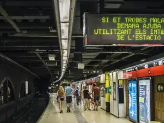

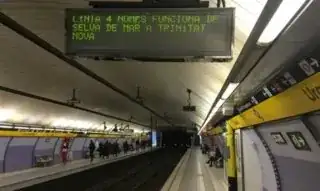

Note that you do occasionally see accented small caps used instead as a workaround in such displays:
(note, the above signs are Catalan, not Spanish)
