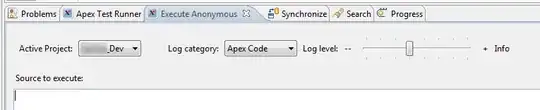

Eclipse
If you are capturing the log via anonymous Apex execution you can alter the logging levels that get captured.
With Eclipse you could reduce the Apex Code category to Info and all other categories to None. Eclipse Execute Anonymous Category Log Level
This should greatly reduce the size of your log.

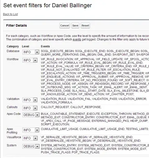

The log filters can also be altered from Setup > Administration Setup > Monitoring > Debug Logs. Then, under monitored users use the Filters link in the action column.
You might find it easier to just use the URL after replacing serverinstance and the user_id values: https://serverinstance.salesforce.com/apexdebug/DebugUserLogSpecification.apexp?user_id=005fullUserId00
Monitoring Debug Log Event Filters

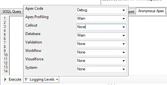

Anonymous Apex:
FuseIT SFDC Explorer Anonymous Apex Logging Levels

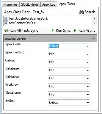

Apex Test Execution:
FuseIT SFDC Explorer Apex Test Logging Levels

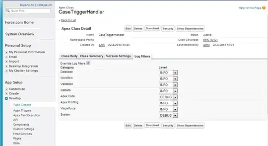

Besides the log filters on the debug log page you can also override the specific log filters for each apex class. If you disable logging for all the apex classes you are not interested in you can minimize your log to what you're really looking for.
You can find this for each Apex class at the Log filter tab on the class detail page.
