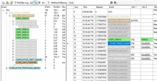

I created a log level that has each category set to None and assigned it to a class and what I get instead of nothing is this noise repeated for every debug statement that would have been there:
11:29:19.0 (16907488)|PUSH_TRACE_FLAGS|[EXTERNAL]|01p60000000UmVB|my class name|APEX_CODE,NONE;APEX_PROFILING,NONE;CALLOUT,NONE;DB,NONE;SYSTEM,NONE;VALIDATION,NONE;VISUALFORCE,NONE;WAVE,NONE;WORKFLOW,NONE 11:29:19.0 (17017401)|POP_TRACE_FLAGS|[EXTERNAL]|01p60000000UmVB|my class name|APEX_CODE,DEBUG;APEX_PROFILING,DEBUG;CALLOUT,DEBUG;DB,DEBUG;SYSTEM,DEBUG;VALIDATION,DEBUG;VISUALFORCE,DEBUG;WAVE,INFO;WORKFLOW,DEBUG

Unfortunately that is the primary logging telling you about the transition into the class specific logging levels and back via the PUSH_TRACE_FLAGS and POP_TRACE_FLAGS events.
Say you call from the transaction into class B that has a specific TraceFlag with LogType 'CLASS_TRACING'. If the System level logging on the transaction is set to INFO or lower you will get the PUSH_TRACE_FLAGS on the way in and then POP_TRACE_FLAGS when the method completes. The problem you are seeing is if class B then makes calls out to other classes (both constructors and methods). These calls will all also get their own PUSH/POP pair. If class B has a lot of dependencies on other classes your log could be rapidly growing again.
I suspect it has some roots in the known issue - Spring 16 Class-level trace flags overriding general trace flags when more restrictive. If every transition between classes isn't considered it isn't possible to determine the correct logging levels that should be applied.
The simplest fix would be to set the System level debugging to NONE for the transaction.
Another alternative is to use a third party Apex log parser that can explicitly ignore certain log events. It won't directly help with Apex log size issues, but will make the log more readable.
