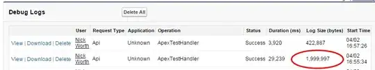

Per sfdcfox's comment I was able to verify that the issue IS because I'm hitting the 2MB debug log limit. This can be see by going to Setup > Monitoring > Debug Logs
SOLUTION:
The now problem is slimming down the debug log and for suggestions on how to do that, refer to this post: Need to get logfile smaller
