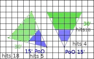

If you use the simple geometry suggested in the PHB, this is simple.
A cone’s width at a given point along its length is equal to that point’s distance from the point of origin.
So at 5' out, it's one square wide, at 10' out, it's 2 squares wide, at 15' out, it's 3 squares, and so on. See the two examples on the left side of the picture below for simple, straight lines.
Shooting out at 45 degrees gets a bit more tricky, as the distances go horizontal and vertical, but at each distance away, if you are 6 squares out, there are six total squares horizontally and vertically from that point.
5e Cone AOE
Similar to CultOfTheD20's answer, I drew a picture. The blue are 15' cones, green extending to 30' cones. No matter the angle you hit approximately the same number of squares.
  1. Determine your ending center point (at cone length)
  2. Determine the end points of the far edge (half the length to either side)
  3. Draw the triangle back to the origin
Squares more than half covered are hit. Squares that are iffy fall to DM's discretion.
