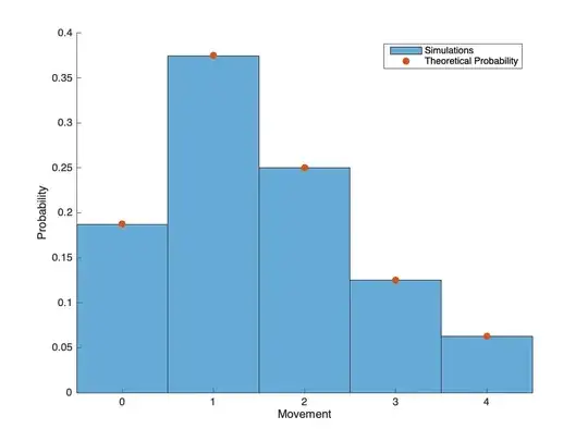

A further confirm can be obtained by simulating the rolls and computing the distances via your rules. The histogram below depicts the simulation of 1 million rolls (blue bars) and compares the empirical distribution with the theoretical one (orange dots). Comparison between theory and simulation

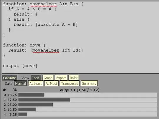

Eddymage's answer is correct, but I thought I would provide a supplementary answer to introduce one of RPG.SE's favorite tools: AnyDice. (We even have a tag for it: .)
After wrestling with some error messages for a while, I was able to implement your rolling strategy using two functions:
  • movehelper: takes two numbers (i.e. the results of your rolls) and returns the difference between the higher and the lower, unless both numbers are 4, in which case it returns 4.
  • move: feeds two 1d4s into movehelper and returns the result. (This is technically unnecessary—you could call output [movehelper 1d4 1d4] directly— but I liked the idea of having a neat wrapper.)
The program is here: https://anydice.com/program/3162d
A screenshot of the AnyDice program described and linked above, including its outputs
As you can see, AnyDice shows you the probabilities of each result.
  • 0: 18.75% chance
  • 1: 37.5% chance
  • 2: 25% chance
  • 3: 12.5% chance
  • 4: 6.25% chance
The two numbers in parentheses after "output 1" are the mean/average result (1.5) and the standard deviation (1.12).
You mentioned in a comment that you might want 0 and 3 to be equally likely. Under your current scheme, 0 has a 3/16 chance of occurring, while 3 has a 2/16 chance.
The simplest way to implement this would be to say that a double-1 roll is not a valid result, i.e. roll again. This would change the chances of both 0's and 3's to 2/15.
AnyDice program for that strategy: https://anydice.com/program/31632
A screenshot of an AnyDice program almost identical to the previous program, but modified to return no result when both dice are 1.
This raises your mean result to 1.6.
