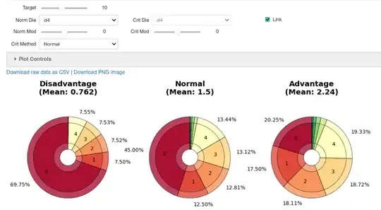

For funsies, I took a stab at an exploration calculator/interface using dyce¹ and anydyce². You can play around with it in your browser: Try dyce [source]
The substantive code is in expected_damage.py. It imposes a minimum on normal damage of zero, and a separate, additional minimum on crit damage of zero. This is to accommodate oddball damage dice (e.g., 1d8-2, where there is a chance outcomes could go negative without limits). This means that, with negative modifiers, this calculator will arrive at different results than pure averages. The source could be easily modified to support alternatives (e.g., a house rule that said minimum normal damage is one and minimal additional crit damage is one). It is possible to express such limits using a formula, but things tend to get a bit verbose. (Spreadsheet implementers should also keep this in mind.)
anydyce burst plots
The above screenshots are for a target of 13 using a Champion Fighter's Improved Critical mechanic with normal damage of 1d6+3 and crit damage of an additional 1d6.
