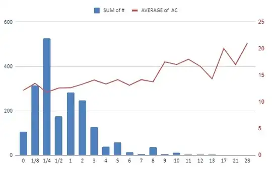

Well actually, I did it for one example: below is the distribution of monsters encountered over the whole of the Tomb of Annihilation campaign module that goes from level 1 to 11, 485 encounters in total. This is not perfect, as it just tallies all of the fixed encounters in the module, plus counts each random encounter once, and not all of the random encounters are exactly equally probable. But given the frequency of encounter checks, they are all improbable enough that you would not expect to have each more than once on average, so it should be a reasonable approximation. The "Sum of #" bars show how many monsters of that CR can be encountered (blue numbers), the red "Average AC" line shows the average AC for these monsters (red numbers).
Encounter distribution in Tomb of Annihilation

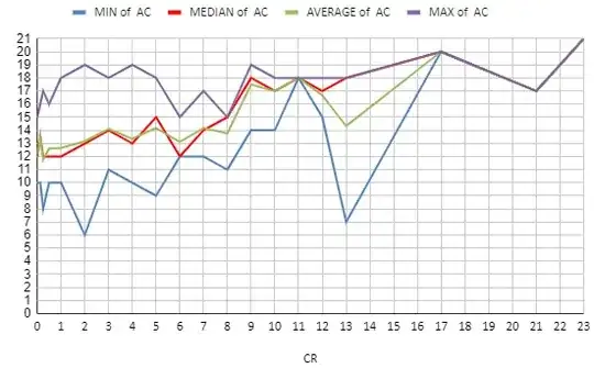

What you can see is that the average AC of the monsters encountered is relatively flat and slowly increasing matching the theoretical values predicted above quite well. Encountering a monster a couple CRs higher and lower will not make a huge difference. You also can see that the vast majority (about 90%) of creatures encountered in this campaign is of CR 3 or lower, because these often tend to appear in somewhat larger groups. Above CR 12, we are dealing with unique monsters encountered as singletons.
The chart below shows the span of ACs encountered at each challenge rating. The lowest ACs are 6 (a couple of Yellow Musk Creepers at CR 2) and 8 (a lot of Zombies in the jungle at CR 1/4). The higest ACs are 19 for a few Will-o'-the-Wisps (likewise at CR 2, the widest spread) and a couple of unique monsters like a dragon turtle, a lich or Acererak. The outlier that is dragging the average down at CR 13 with only 7 AC is the Atropal. This of course is expected: not every monster will match the average AC, individual encounters can have much higher, or much lower numbers.
What is evident is that the median (that is, the most often encountered AC) is quite close to the mean across the entire range up to where we get to deal with unique encounters after CR 12 (demons and beholders all with AC 18 vs the Atropal with 7). That is, for most fights, the average AC number per CR is a pretty good approximation to the commonly encountered AC. The outliers are rare.
Span of AC

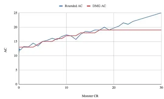

4 Another approach is to look at the monster building guidelines in DMG p. 275 to determine what AC per CR "should be", but that is not used here. Below is a comparison, which shows that both are relatively similar, as long as you stay away from very high CRs (rounded AC is to one digit after the decimal point as above for Avg AC):
Comparison of average MM AC and DMG Monster Design AC
