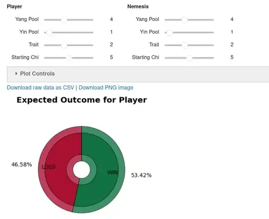

Somewhat inspired by our discussion in @HighDiceRoller's answer, I adapted my former work-up for multi-round combats in Risus using dyce¹ and put together an interactive widget using Jupyter that might help. One limitation is that it only allows configuring pool allocations for the entire combat, not per-round:
Widget Screenshot
That being said, after playing around with it and assuming I understand the mechanic (and got my math and my widgets wired up right), I'm not sure it's ever a good strategy to dedicate any dice to defense. (Others more careful and observant than me are encouraged to chime in on the dubiousness of my conclusion.)
anydyce² is used to to generate "burst" graphs. You can play around with it in your browser: Try dyce [source]
If you speak Python, the substantive implementation can be found in nemesis.py. Be warned that it uses recursion within nested functions, which probably makes it harder to wrap one's head around. But it's pretty performant compared to AnyDice, mostly because of memoization (i.e., use of Python's @functools.cache decorator).
