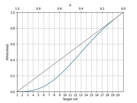

Converting \$p\$ to the target number on a straight d20 roll, we get the following plot. (The straight grey line represents the probability of failing on a single saving throw.)
Probability of being petrified
When the number you need to roll (the spell save DC minus your Constitution save modifier) is 13 (or p≈0.4), you have a 50% chance of being petrified. If you have advantage on the rolls, the 50% mark happens when the target number is between 16 and 17. If you have disadvantage on the rolls, the 50% mark happens when the target number is between 8 and 9.
The multiple saves required for flesh to stone skews the odds slightly in favour of the target compared to a single-save spell, especially when the roll is easier.
