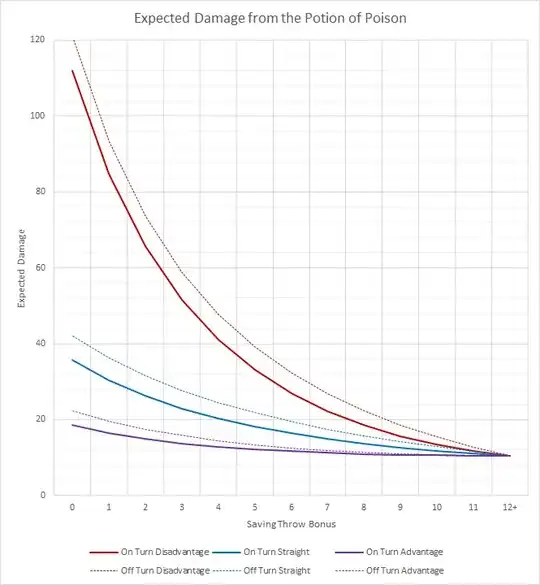

And here is a chart showcasing the magnitude of the difference between disadvantage and advantage for non-negative CON save bonuses:
As you can see, having disadvantage on the saves against the poison can be very perilous when your CON save bonus is low.

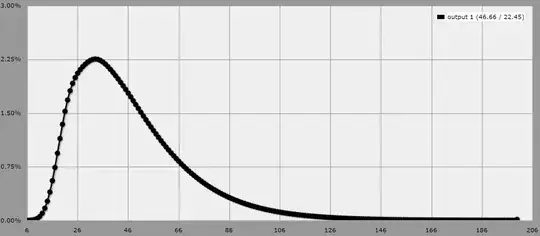

Full distribution using AnyDice
Double bonus points if you can provide more detailed information than just the mean damage (like a statistical distribution of damage).
Link.
set "explode depth" to 100
function: potion of poison dice FAIL_SAVE:d { result: 3 * (1 + [explode FAIL_SAVE]) + 2 * (1 + [explode FAIL_SAVE]) + (1 + [explode FAIL_SAVE]) }
output [lowest of [potion of poison dice d20+1<13] and 100]
Distribution of damage dice.
This assumes that the potion is drunk during the character's turn and the first save is failed. The output is in terms of the number of damage dice. In terms of damage:
output [lowest of [lowest of [potion of poison dice d20+1<13] and 100]d6 and 200]
Distribution of damage.
How it works
This uses the same strategy as my answer to another question. Namely:
The number of tries consumed by each "stage" in the series is independent, so we can just sum them.
From here, the number of failures experienced in each stage follows a geometric distribution. This is already well-explained in the other answers so I will not belabor the point here.
We can compute each of the stages by applying the built-in explode function to a single try at that stage:
  • A 0 on a single try represents a success, terminating the explosion and that stage.
  • A 1 on a single try represents a failure, consuming a try and forcing the character to try again, represented by the explosion.
We also add the one guaranteed instance of damage at each stage (with the initial damage substituting for this in the 3d6 stage).
We do need to increase the explode depth since AnyDice's default of 2 is too small for this purpose and would only count up to 3 failures per stage.
The [lowest of ... and 100] is simply to cut off the graph at a reasonable end for visualization and could be omitted if you're just interested in the number of d6s. However, AnyDice does not appear to be super-efficient at computing variable numbers of d6s, so if you want to convert this to the distribution of damage, you may want to keep the dice cap and/or lower the explosion limit to prevent timeouts.
