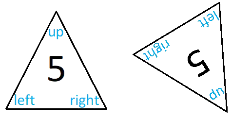

To directly implement a d6 or a d12, you can increase your d20 to a d60, by using the fact that
Every face of a standard d20 has 3 distinctive vertices.
Looking at an example face, it is seen that the number defines the 'up' direction, as well as 'left' and 'right':
Two triangles (left and right). The left triangle displays a 5 in the middle and the corners are denoted "up", "left" and "right". The right triangle is a rotated version of the left triangle
Therefore, the three vertices of a face can be distinctively described as "upper vertex", "left vertex" and "right vertex".
After the die is rolled, you look not only at the rolled number, but also which of the three vertices is furthest away from you.
  • If the "upper vertex" is furthest away from you, use the rolled number as-is.
  • If the "right vertex" is furthest away from you, add 20 to the rolled number.
  • If the "left vertex" is furthest away from you, add 40 to the rolled number.
Then, de facto you have a d60. This allows for a direct implementation of a d12 (by dividing the numbers 1-60 into 12 partitions of the same size).

As described by Thomas Markov in his answer, one could use the triangle shape of the d20 to create a kind of d3 (or d12) rolling mechanism. However, it relies on judgement. That is, you have to decide which corner is furthest from you... or if you can't decide it, you take the one nearest. That creates a situation where one could conceivably take any of three results, should it be a "too close to call" situation.
It looks like it's very close to being a "pointing down" position? Move your head ever so slightly so that the one you want is at the top, or position yourself so that they're equal and then take the one at the bottom.
So long as all players are honest, the system will work fine, of course.
