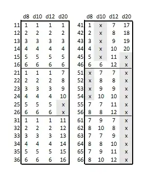

Use this chart
I made this fairly quickly in Excel, and it builds off of Jakub Konieczny's answer. Roll a d6 twice (or if you have different d6, designate one as the "tens" and the other as the "ones". I tried to organize the conversions so that figuring out your roll is as easy as possible, and eventually you might not even need the chart. Looking at the chart now, I can see a few things I'd do differently were I going to rework it, such as making 11-20 start at 41 and go to 54.
Assuming you have 2 different d6, I might suggest making a d4 chart rather than just rolling a d6 and rerolling on 5-6.

    It looks like you've got a small error in the d10 column: the result 6 shows up four times instead of three. I assume you meant to put an "x" in row 46. – Tanner Swett Apr 03 '20 at 17:37
  • It's true! I did put this together fairly quickly. I'll get an updated version up at some point (might also switch the d20 chart around to be more memory friendly) – aslum Apr 03 '20 at 17:38

D20 = 4d6 - 3 reroll all sixes.
D100 - this is very hard to do unless you use 2 D10 rolls, as the more dice you add the closer the result comes to the average of 3.5/die so if you rolled 17d6-2 (15-100) most of your results will be around 60.
Rethinking my answer based on Jason's answer.
y(dx-1) + dy will give you a result from 1 to yx so while we can't reproduce certain dice because they don't fit in any multiple of y, we can do any number of base y digits we want just by adding another dx to signify the next digit. On a d6 we can easily make d2 and d3 without needing to reroll. So we can easily make 1-2, 1-3, 1-4 (y=2), 1-6, 1-9 (y=3), 1-12, 1-18, and 1-36. These will also be done with an even probability in the same way a traditional d100 does with 2d10. This might be enough to do dnd.
So in summary we either have to sacrifice probability for numbers or we have to sacrifice dice types for probability.
