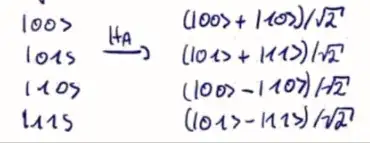

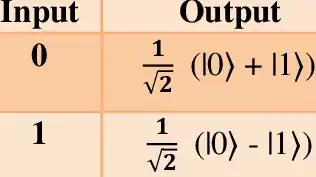

So in lectures I see lots of these:
And somehow I intuitively understand it (at least for the 1 qubit case), but I don't understand the math – especially for 2 qubits.

First, you should note that the Hadamaard gate is nothing more than a $2 \times 2$ Discrete Fourier Transform matrix (two-point DFT). That is the reason why, $H \bigg( \dfrac{|0\rangle + |1\rangle}{2}\bigg) = |0\rangle $, and $H \bigg( \dfrac{|0\rangle - |1\rangle}{2}\bigg) = |1\rangle $. Think "periodicity"...
Now, the Hadamard gate, which is again just a two-point DFT, can be written out explicitly as:
$$ H = \dfrac{1}{\sqrt{2}}\begin{pmatrix} 1& 1\\ 1 & -1\\ \end{pmatrix} $$
and $|0\rangle = \begin{pmatrix} 1 \\ 0 \end{pmatrix} $ and $|1\rangle = \begin{pmatrix} 0 \\ 1 \end{pmatrix} $. These are the standard euclidean basis. So naturally we take them as the computational basis for quantum computation. Now, you can work out the linear algebra (and it seems like you already did, as you mentioned in the question):
$$ H|0\rangle = \dfrac{1}{\sqrt{2}}\begin{pmatrix} 1& 1\\ 1 & -1\\ \end{pmatrix} \begin{pmatrix} 1 \\ 0 \end{pmatrix} = \dfrac{1}{\sqrt{2}}\begin{pmatrix} 1\\ 1 \\ \end{pmatrix} = \dfrac{1}{\sqrt{2}}\bigg[ \begin{pmatrix} 1\\ 0 \\ \end{pmatrix} + \begin{pmatrix} 0\\ 1 \\ \end{pmatrix} \bigg] = \dfrac{1}{\sqrt{2}}\bigg[ |0\rangle + |1\rangle\bigg] $$

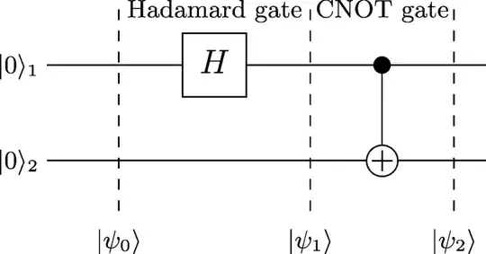

Going a little further: Since we are already at this point, I thought I should add this extra bit in here too. Suppose you see the following circuit:
This is quantum circuit, starting with the initial state $|\psi_0\rangle = |00\rangle = |0 \rangle \otimes |0\rangle$. Then it apply the Hadamard gate to the first qubit. This is similar to the question you asked. So based on what we did above, we have that
\begin{align} |\psi_1 \rangle &= (H \otimes I) \big( |0\rangle \otimes |0\rangle= \dfrac{1}{\sqrt{2}} \begin{pmatrix} 1 \\ 0\\ 1 \\ 0 \\ \end{pmatrix} = \dfrac{1}{\sqrt{2}}\big( |00\rangle + |10\rangle \big)\\ \end{align}
Now, we apply a gate known as the CNOT gate to both of the qubit. CNOT gate is a two-qubit gate as so you cannot think of it as tensor product from one-qubit gate. The function of CNOT (controlled-NOT) is to apply the $X$ gate to the target-qubit when the controlled-qubit is $|1\rangle$. It is therefore can be written in matrix form explicitly as
\begin{equation}\label{CNOT matrix} CNOT = \begin{pmatrix} 1 & 0 & 0 & 0\\ 0 & 1 & 0 & 0 \\ 0 & 0 & 0 & 1 \\ 0 & 0 & 1 & 0 \\ \end{pmatrix} \end{equation}
Now, we apply the CNOT gate to $|\psi_1\rangle$, which will give us $|\psi_2\rangle$. That is
$$CNOT|\psi_1\rangle = |\psi_2\rangle $$
And explicitly writing this out as matrix and vector multiplication, we have
$$ |\psi_2 \rangle = \begin{pmatrix} 1 & 0 & 0 & 0\\ 0 & 1 & 0 & 0 \\ 0 & 0 & 0 & 1 \\ 0 & 0 & 1 & 0 \\ \end{pmatrix} \dfrac{1}{\sqrt{2}} \begin{pmatrix} 1 \\ 0\\ 1 \\ 0 \\ \end{pmatrix} = \dfrac{1}{\sqrt{2}} \begin{pmatrix} 1 \\ 0\\ 0 \\ 1 \\ \end{pmatrix} = \dfrac{1}{\sqrt{2}} \big( |00\rangle + |11 \rangle \big) $$
This quantum circuit generate the state $\dfrac{1}{\sqrt{2}} \big( |00\rangle + |11 \rangle \big)$ which is one of the four Bell states, which are maximal entangled state for two qubit.

  • Question. a) Why does column (1,1) is same as |0>+|1>. Is there also some math for conversation, or is just assumption in QC world? b) And similarly - how does the column (1,1,0,0) turn into |00>+|01>?
  • – John T Oct 09 '20 at 07:04
  • @JohnT I have added the reason for why that is the case. It's not assumption. It's because how the vectors, $|0\rangle$ and $|1\rangle$ are defined. – KAJ226 Oct 09 '20 at 15:47
    @JohnT I have added even more details to the answer. Take a look. I think this will help you to understand the math going behind QC notations. – KAJ226 Oct 09 '20 at 16:01
  • Thank you. It's now much clearer to me! (thumbs up) – John T Oct 09 '20 at 19:04
  • I did go again trough the answers and Im confused. The below solution and the lecture material says that H of |00> is |00>+|10> , but ur calculus says |00>+|01>. Where is the error? – John T Oct 09 '20 at 21:04
  • @JohnT This is because the lecture apply the Hadamard gate to the first qubit and I apply the Hadamard gate to the second qubit. I thought I should do something similar but different so you see the point. – KAJ226 Oct 09 '20 at 21:11
  • Ahhhhhhhh. Ok... – John T Oct 09 '20 at 21:14
  • @JohnT I added that bit in now at the end so you can see it better. Hope this helps. – KAJ226 Oct 09 '20 at 21:24
  • @JohnT I added a bit about quantum circuit and how to work out the math of what the circuit does explicitly for you at the end of the answer as well. – KAJ226 Oct 09 '20 at 21:47
