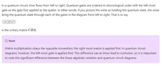

I found a Microsoft article and I think it has something to with that. It says:
Microsoft Article
I think this is weird. Can someone explain it?

    "I think it is weird." Unclear what "it" refers to, and which part you're finding weird. – Frank Yellin Nov 30 '22 at 02:05
  • Also useful would be this answer: https://quantumcomputing.stackexchange.com/questions/14066/how-do-i-apply-the-hadamard-gate-to-one-qubit-in-a-two-qubit-pure-state – Mike Ryan Nov 30 '22 at 02:35
  • The equation after "Building the register: reg1 := q0 tensor q1 =" is not correct. As Frank Yellin says in his answer below, the vector you wrote is $|+\rangle \otimes |0\rangle$, whereas you are looking for $|0\rangle \otimes |+\rangle = \begin{bmatrix} 1/\sqrt{2} \ 1/\sqrt{2} \ 0 \ 0 \end{bmatrix}$. Then if you follow your logic after that, you will get the same result as your first method. – sheesymcdeezy Jan 06 '23 at 13:14
I'm not sure what you find confusing. You start off with with the matrix:
$$\begin{bmatrix} 1/\sqrt2 \\ 0 \\ 1/\sqrt2 \\ 0 \end{bmatrix}$$ which is $|+\rangle \otimes |0\rangle$.
Then: $$(H\otimes I)(|+\rangle \otimes |0\rangle) = (H|+\rangle) \otimes (I|0\rangle) = |0\rangle|0\rangle$$
$$(I\otimes H)(|+\rangle \otimes |0\rangle) = (I|+\rangle) \otimes (H|0\rangle) = |+\rangle|+\rangle$$
Which is exactly what you got in your calculations.
