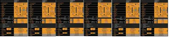

Screenshots of option pricing in Bloomberg here

    There are two different time gaps in OVML: a) time to expiry = Expiry Date - Price Date b) time to delivery = Delivery Date - Premium Date Quantlib seems to not compute this (like Matlab for example also doesn't distinguish this). You can see the premium date at the bottom of the OVML screen. – AKdemy Mar 22 '22 at 15:21

Result for the first day that is different, as well as the initial day to compare this.
There are minor rounding differences to BBG because I only used the fwd points visible in the screenshot, which lacks the exact decimal precision.
