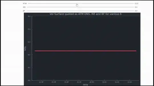

Now, none of this applies to spot fx options. OTC traded FX options are quoted in IVOL. ATM DNS (Delta Neutral Straddles), Risk Reversals and Butterflies for various deltas. The GIF below shows how this builds a vol surfaces. As you can see, the outcome /shape is similar to SABR. After all, the idea of the CME FX options vol converter is to provide price transparency between the OTC and CME options markets.
These quotes have a cut-off time (frequently New York 10am) when the option expires. EURGBP is by convention also delta premium included. This is explained in this mathfinance paper by Uwe Wystup and Dmitri Reiswich. This answer shows in Julia code what delta premium adjusted means. Solving for strike is not that trivial in this case and requires a root solver.
