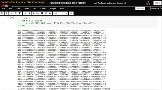

julia> i = 0.1
for N = 20:20:500
    println(10*(BigFloat(1+i)^N-1)/i-(100*(BigFloat(1+i))^N))
end
looks like this: enter image description here

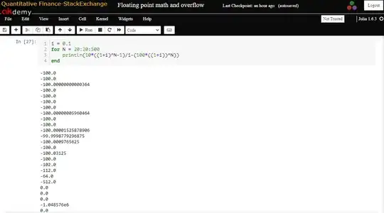

Note that it would silently overflow without the BigFloat in Julia. enter image description here
Probably even more importantly though, the inexact representation of rational numbers as floating point numbers becomes more and more problematic the bigger the exponent is in the above function (as can be clearly seen in the first screenshot).
