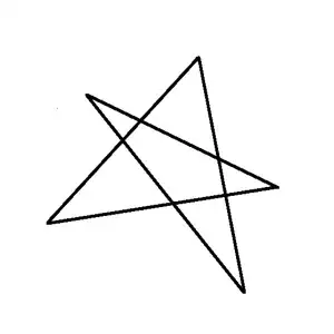

I can sketch a proof based on assuming this "finite" result:
A). For any pentagonal star one of the 5 triangles will have area strictly smaller than that of the central pentagon. (I think a brute force attack should yield a proof here.) star

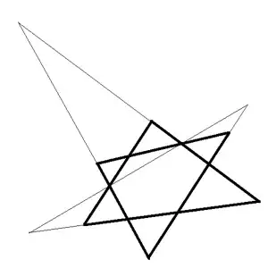

b). A) generalizes to n-agons by considering the pentagon spanned by any 5 vertices. hexagon
c). b) implies that a tiling with polygons of EQUAL AREA is not possible unless all polygons are either triangles or quadrilaterals.

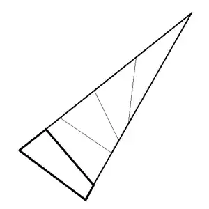

d). Take one 4-tile and continue tiling next to it inside the cone enclosed by the converging lines of 2 opposite edges; we have a sequence of quadrilaterals which must end with a triangle were the the 2 lines meet. This shows that the tiling must contain a 3-tile somewhere.
4-tile

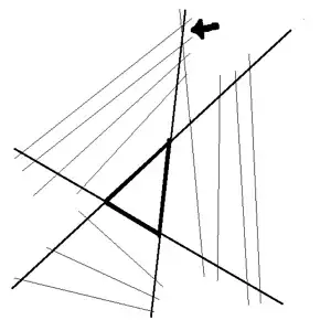

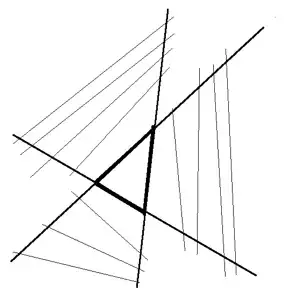

e). By d) take a 3-tile and continue tiling outwards, inside each of the 3 beams generated by the lines of each pair of edges; the original 3-tile will be the first tile in each beam, but every other tile after it must be a 4-tile (build them one at a time and keep using c)). We can ignore what happens in the 3 leftover cones radiating from the 3 vertices.
3-tile
f). In one of the 3 beams (which now look like ladders) take any one of the new rungs from step e) and extend it - that line will then collide with one of the other 2 beams (but cannot overlap with any of its rungs). That will cut one of the 4-tiles, creating a 5-tile.
contradiction!
