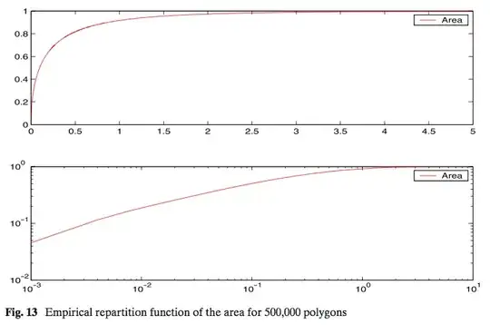

Some numerical results for the first seven moments of the area (with parameter 1 so that $\tau=\pi$ in the notation above) from generating 250,000 polygons are in a 2007 paper by Michel and Paroux: 0.31813 (exact is $1/\pi\approx0.31831$), 0.5009 (exact is $1/2$), 1.8042 (exact is $4\pi/7\approx1.7952$), 11.47, 113.9, 1610, 29400 (where I've rounded off some unnecessary digits from their Fig. 8). They also have a figure showing the cumulative distribution function for the areas:
Figure 13 from Michel and Paroux
The behavior near zero area is apparently explained by the following asymptotic result for the probability density function for the areas (part of Theorem 6 in Miles's paper above): $P(A\in dx)=c\tau A^{-1/2}+O(\tau^2)$, where $c=\frac{1}{3\pi}\int_0^\pi d\phi\int_0^{\pi-\phi}d\psi \sqrt{2\sin\phi\sin\psi\sin(\phi+\psi)}$ which Mathematica tells me is about 0.32311.

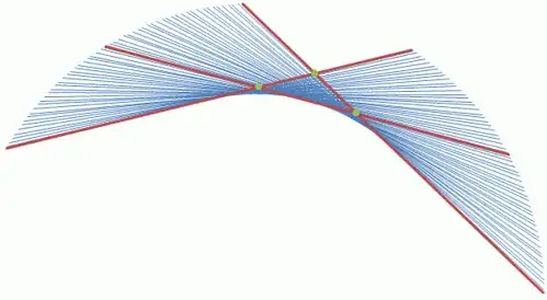

(Edit:) I think I may have misunderstood the question. Here are some results for polygons created by finite samples from an infinite family of lines:
Let each line have a point on the unit circle, at angle θ anticlockwise from the x-axis, where 0 ≤ θ < 1. Each line has another point also on the unit circle, at angle φ anticlockwise from its start angle. (Here, φ is the golden ratio, (1+√5)/2.) We get this:
http://www.flickr.com/photos/edwynn/5871622044/
This image shows lines (in blue) where the angles θ were generated by the start of the quasirandom sequence (nφ mod 1). This countable infinite sequence is guaranteed not to have any parallel lines. In this family, different angles also guarantee non-coincident intersections.
The image is marked up with the largest possible triangle (in red), with area ≈0.017. So, this is a case with an upper bound on area. In fact, all intersections (and therefore all polygons) fall inside that triangle plus the curved parts just below it.
From a random sample of 100,000 examples, this is the distribution of triangle areas: http://www.flickr.com/photos/edwynn/5871622056/ http://www.flickr.com/photos/edwynn/5871622082/
I agree that it seems unlikely that areas could all be both finite and nonzero, but I have no proof.
Ed Wynn
