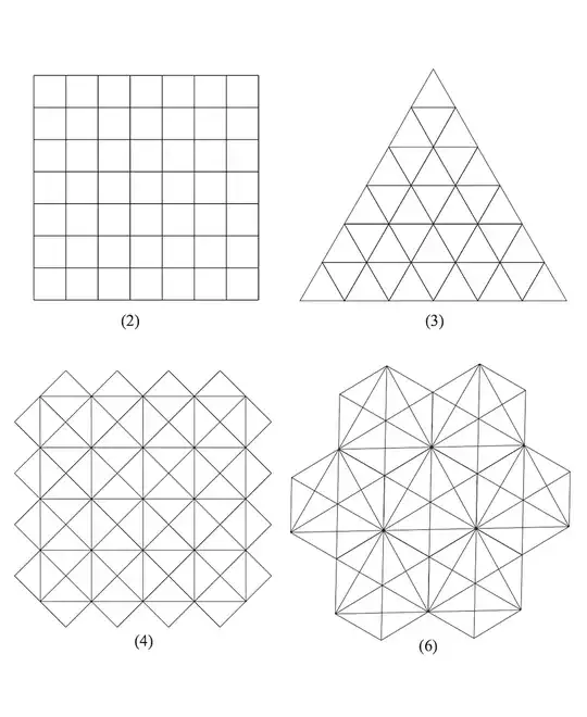

An infinite countable family $\cal{L}$ of straight lines in the plane $\mathbb{R}^2$ forms a fair cutting of the plane if the following conditions are satisfied:
$\bullet$ No circle intersects infinitely many lines from the family $\cal{L}$;
$\bullet$ Let $L$ denote the union of the lines in $\cal{L}$. Each connected component of the complement of $L$ is a bounded set; the closure of each of these sets will be called a cell (observe that each cell is a convex polygon). This condition requires that the diameters of the cells formed by the cutting have a common upper bound;
Finally,
$\bullet$ All cells are of the same area.
We say that two fair cuttings are affinely equivalent if there exists an affine transformation of $\mathbb{R}^2$ sending the lines of one family onto the lines of the other. Also, we say that a fair cutting $\cal{L}$ is extra-fair, if, in at least one of its affine equivalents, all cells are congruent.
Four examples of mutually non-equivalent extra-fair cuttings are shown below.
Question 1. Is there a fair cutting whose at least one cell has more than four sides?
Question 2. Must all cells of a fair cutting have the same number of sides?
Question 3. Is every fair cutting extra-fair?
Question 4. Does there exist another example of a fair cuting, non-equivalent to any of the four pictured here?

    The numbering scheme seems to be that the cutting labeled $(n)$ has a maximum of $n$ lines meeting at one point. –  Mar 20 '21 at 14:39
    @MattF. Yes, I'm glad you've noticed. – Wlodek Kuperberg Mar 20 '21 at 14:42

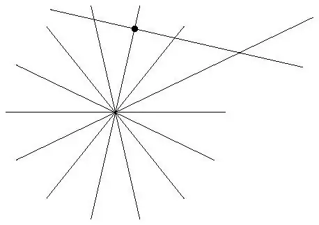

If $n$ distinct lines intersect at a single point, let's say the intersection is regular if the angle between any two lines is a multiple of $\pi/n$. (That is, all the angles are evenly spaced.)

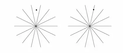

A fair cutting of the plane cannot contain a regular intersection of $n$ lines at a common point, unless $n = 2,3,4,6$ (as in your four pictures).
To see why this is true, let's argue that having a regular intersection of $n$ lines with $n \geq 7$ is impossible. Afterward we'll see how to modify the argument for $n = 5$. (The illustrations are all for $n=7$.)
$\ \ \ \ $(This is impossible.)

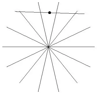

Suppose we have a fair cutting $\mathcal L$ containing $n$ lines, forming a regular intersection at some point $p$, as in the picture above.
Let $L$ be a line in $\mathcal L$, other than those going through $p$, whose distance to $p$ is minimal. Let $q$ be the point on $L$ with minimal distance to $p$. We consider two cases: either $q$ lies on one of our $n$ lines or not.
Drawing the line through $q$, in the first case we get an immediate contradiction: there is a cell containing $p$ and $q$ on its boundary, but the adjacent regions we've just created with our line through $q$ are not an integer multiple of its area. (The area is larger, but having $n \geq 7$, one can show that it is not twice as large.) This is absurd, because these regions should be a finite union of cells.
Now consider the second case, where $q$ is on one of our seven lines through $p$. In this case the line $L$ through $q$ is perpendicular to one of our lines through $p$. This creates two cells containing $p$ and $q$ on their boundary, each of area $A$. But it also creates another adjacent region, with area larger than $A$ but not larger than $2A$. Again, this is a contradiction, since this region should be a union of finitely many cells, each with area $A$.

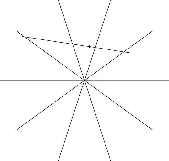

For $n=5$, a similar argument works. The case where $q$ is on a line is exactly the same: we get bounded regions whose areas are not integer multiples of each other. The case where $q$ is not on a line requires just one extra step. In this case it is possible to make two adjacent regions with one double or triple the area of the other (but quadruple the area is impossible):
However, as you can see in the picture, this creates a third region too (the one to the right), and this region is not commensurable with the other two.

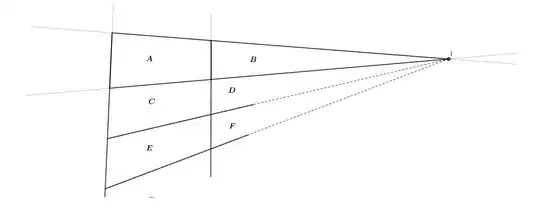

    I think that the idea of commensurability together with each tile having to be a triangle (see my partial answer) could go a long way to attack the problem in a combinatorial sort of way, not too ramified. For a example assuming that there is a simple intersection somewhere (only 2 lines) it may not be too hard to show that the tiling can be continued in only 2 ways, leading to patterns (4) and (6) in the question. – Yaakov Baruch Apr 04 '21 at 22:55
CLAIM. The only fair cutting with at least one quadrilateral is the square grid (2). It was already shown in the original answer (below) that there cannot be $n$-agons for $n\ge 5$.
LEMMA. No fair cutting can contain a non-simple quadrilateral (i.e. one with a non-simple vertex, intersection of more than 2 lines).
PROOF of Lemma. The proof in my original answer incidentally showed that, up to affine transformations, there is a unique quadrilateral with a non-simple vertex, such that none of its ears are smaller than the interior:
and in fact $A_1=A_2=A_3=A_4=A_5=3$. Consider then the region containing the triangle $B$, which has area $6$. The only way to cut that region into smaller tiles involves also cutting at least one of $A_3$, $A_5$ or $A_2$. Therefore the above pattern cannot exist in a fair cutting either.$\quad\quad\blacksquare$
PROOF of Claim.

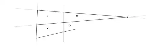

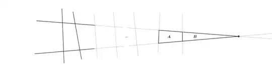

Assume there is a quadrilateral with two opposite sides that are not parallel. By the Lemma the finite ear formed by those 2 sides will be decomposed into a sequence of quadrilaterals until the last piece, which is a triangle. Therefore we always must have a simple quadrilateral adjacent to a triangle:
Next consider the other 2 edges of $A$. On a side where they don't converge there can only be a sequence of simple quadrilaterals (by the Lemma again), starting with $C$:
In order for the tile at $D$ to not cut any of $A, B, C$ and to comply with the Lemma, the only possibility is for it to be a triangle, with its incomplete edge reaching exactly I:
The same reasoning can be repeated with $E$ and $F$, and so on.
The point I must be then be the intersection of infinitely many lines, contradicting the definition of a fair cutting. This proves that any quadrilateral in a fair cutting must be a simple parallelogram, and from there it's trivial to see that all parallelograms must be identical in order to have the same area. Such cutting is equivalent to the square grid by affine transformation. $\quad\quad\blacksquare$
NOTE. If the requirement that only finitely many lines intersect any circle were done away with, then a tiling satisfying all the other requirements would be given by this: all the lines through $(0,0)$ and $(0,n)$, together with all he lines through $(\sqrt{n},0)$ parallel to the $y$-axis. All its tiles have area $1/2$.

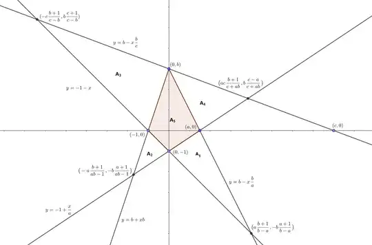

CLAIM. A convex pentagon has at least two ears with areas strictly less than that of the pentagon. The result is optimal, in the sense that it's easy to construct pentagons with 3 ears larger than the interior.
COROLLARY: a convex $n$-agon has at most three ears with area $\ge$ interior area, and this is also optimal. (Hint: draw the chord spanning 2 consecutive ears, one $<$ and one $\ge$ interior area...)

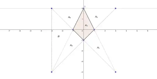

PROOF of claim. First a few reductions, without loss of generality:

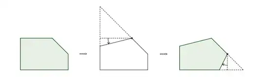

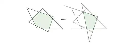

1) Assume each ear to be finite by rotating an edge around one of its endpoints in such a way that: - the infinite ear becomes finite, but still larger than any other finite ear, - a finite adjacent ear increases (and remains finite), - the pentagon's interior is reduced:

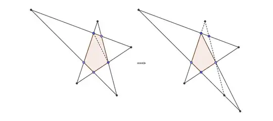

2) The critical step: reduce the *smallest* ear to a point by again rotating one edge around its endpoint, thereby increasing the two ears near the rotation point, and *strictly* reducing the interior of the pentagon to a quadrilateral. (If necessary, repeat step 1) to make all ears finite again.) As a result of this step, it suffices now to prove that one of the new 4 non-degenerate ears has area less than, or equal to, that the quadrilateral's.
3) By an affine transformation one can assume that the diagonals of the quadrilateral lay on the $x$ and $y$ axes, their intersection in the origin and the end points at $(-1,0),(0,-1),(a,0)$ and $(0,b)$, with $ 1\le a<b$:
  Notice that $ a<b$ follows from $A_1<\infty$, and $c$ can be either $>a$, as in the figure, or $<-1$, or $\infty$.
  The 5 areas are now easily computed:
$$A_5=\frac{(1+a)(1+b)}{2}$$
$$A_1=A_5\frac{a}{b-a}$$
$$A_2=\frac{A_5}{ab-1}$$
$$A_3=A_5\frac{b|c+1|}{(1+a)|c-b|}$$
$$A_4=A_5\frac{ab|c-a|}{(1+a)|c+ab|}$$
From the third formula: $A_2\ge A_5\implies ab\le 2$.
Case $c>a$: $$ \displaystyle ab\le 2, a\ge 1 \implies A_4=A_5\frac{ab}{(1+a)}\cdot \frac{|c-a|}{|c+ab|}<A_5$$ and we are done.
Case $c<-1$: $$\displaystyle ab\le 2, a\ge 1 \implies A_3=A_5\frac{b|c+1|}{(1+a)|c-b|}\le A_5\frac{ab}{(1+a)}\cdot \frac{|c+1|}{|c-b|}< A_5$$ and again done.
Case $c=\infty$: $$\displaystyle ab\le 2, a\ge 1 \implies A_3=A_5\frac{b}{(1+a)}\le A_5\frac{ab}{(1+a)}\le A_5\quad \text{and}\quad A_4=A_5\frac{ab}{(1+a)}\le A_5$$
Here notice that the inequalities are not strict. In fact $A_1=A_2=A_3=A_4=A_5$ if and only if $a=1$, $b=2$. However this is sufficient since step 2) involved a strict decrease of the pentagon's area. $\quad\quad\blacksquare$

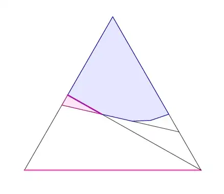

Lemma. If, in a triangle-free fair cutting, there exists a triangular block such that one its (open) sides is not cut by any other line, then there exists a smaller such block inside of it.
This shows that such blocks in fact cannot exist in fair cuttings with no triangles, because then there would be infinitely many lines intersecting the block. I will show at the end that there is always such a block if one of the cells in not a parallelogram or a triangle. It means that if there are no triangles, all cells are parallelograms or triangles, so in fact they are all parallelograms (which means we are in the case (2)).
The proof of the lemma is essentially contained in the following picture.
A smaller triangle in the block
Up to an affine transformation, the triangular block $T$ cannot be cut on its base, highlighted in pink. The top part of $T$ has to belong to some convex polygonal cell $C$, highlighted in blue (the apex cannot be cut, otherwise the base would be cut as well). This cell cannot use the base as part of its boundary, since the base cannot be cut, so the boundary defines a convex polygonal path from the left side of $T$ to the right one. Consider the two leftmost pieces of this path. Extending the second piece to the left, and using the left side of $T$, this defines a smaller triangular block, whose top side, the one touching $C$, cannot be cut. This concludes the proof of the lemma.
