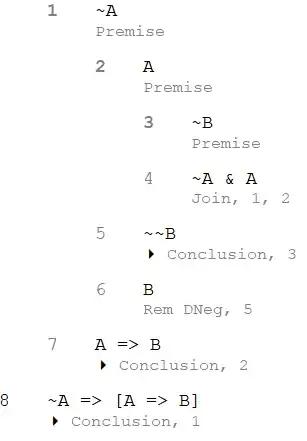

If you will eventually be teaching the basic methods of proof (conditional proof, proof by contradiction, etc.) in your course for math majors, you might consider starting with the truth tables for NOT, AND and OR and postpone the truth table for IMPLIES until they understand some of those basic methods of proof. Then they should be able to understand a proof of ~A => [A => B] (see below) which corresponds to lines 3 and 4 of the usual truth table for IMPLIES, and IIUC is usually where problems seem to arise. (Screenshot from my proof checker.)
Dan Christensen
  • 1,094
  • This is a nice proof. I think this software would be more useful if it indicated which rules were being used to make the conclusions. Line 1 starts implication introduction which line 7 finishes. Line 3 starts negation introduction which line 5 finishes (I was confused by the indentation here). – Steven Gubkin Sep 18 '21 at 11:57
  • @StevenGubkin The Conclusion Rule looks at the previous line to determine if it is a contradiction or not. For the conclusion on line 5, for example, the previous line (4) is a contradiction., so the conclusion will be the negation of the premise on line 3 (as indicated), and lines 3 and 4 will be "deactivated" (indented) and cannot be referred to on subsequent lines. ... – Dan Christensen Sep 18 '21 at 12:38
  • ... For the conclusion on line 7, the previous line (6) is not a contradiction, so the premise on line 2 and the statement on line 6 are used to generate a conditional statement. This results in lines 2 to 6 being "deactivated" (indented). Like any software, it takes a bit of getting used to. The tutorial starts with the simplest possible example, proving A & B => B & A. – Dan Christensen Sep 18 '21 at 12:44

Interestingly, if it is not raining ($\neg R$), then it is true that $R\implies C$, regardless of the truth value of $C$ (see lines 3 and 4).
$~~~~\neg R \implies (R\implies C)$
Note that we cannot infer from this statement that $C$ is true, or that it is false since $A$ itself is false.
This is the so-called Principle of Vacuous Truth. It is rarely if ever used daily discourse since we don't usually give much consideration to implications with a false antecedent. It is, however, a valid and useful method of proof in mathematics.
