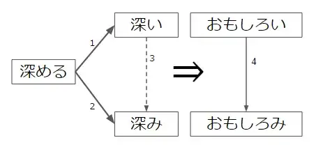

It then seems that these may be possible processes (taking one of the ~める verbs as an example):
mi suffix chart
In this hypothesis, the verb is the origin. Some unknown mechanism (1)(Verb to Adj) generates a い adjective, and another mechanism (2)(Verb to Noun) generates a み-noun. Following this, a relationship between the adjective and the noun develops (3)(Adj to Noun). Then, this new mechanism (3) is extended to adjectives that do not have a corresponding verb containing a -m- sound, which is mechanism (4).
Comparing mechanism (2) to the 終止形 to 連用形 conjugation rule, we note that it is also of a similar type, that is to say that it is a process that is "Verb to Noun". E.g. 笑う→笑い.

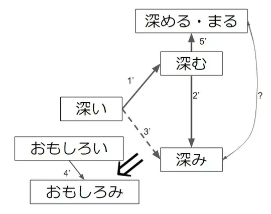

In another hypothesis, I take the adjective to be the starting point. Where after (1') it gets a む to become 深む (Which may be an old verb form. See: Rare/Obsolete verb forms and How do 自他 triplets of related verbs work?) and then goes on to conjugate normally to 連用形 to get the み ending. As above, the association between the adjective and noun (3') is formed and is extended (4') to adjectives that do not go through (1'):
This gives me a suspicion that there might exist a verb-like む morpheme hidden in the history of the words that contemporarily do not have an explicit -m- sound in order for them to conjugate to a 連用形 containing み such that the processes A and B (right at the beginning of this question) are actually underlyingly the same process.

  • Hm... I don't really understand the question now. I would have thought that adjectives (like 深い) are the starting point and that there was an auxiliary verb(?) ~む that attaches to the stem of such adjectives (to give 深む "to deepen"). The meaning of this auxiliary verb would be "to become [adjective]". The 連用形 of this auxiliary verb could now be fossilized as the suffix ~み (with a slightly different meaning). – Earthliŋ Nov 28 '16 at 14:35
  • @Earthliŋ that means that I might have misidentified the starting point. – Flaw Nov 28 '16 at 14:37
