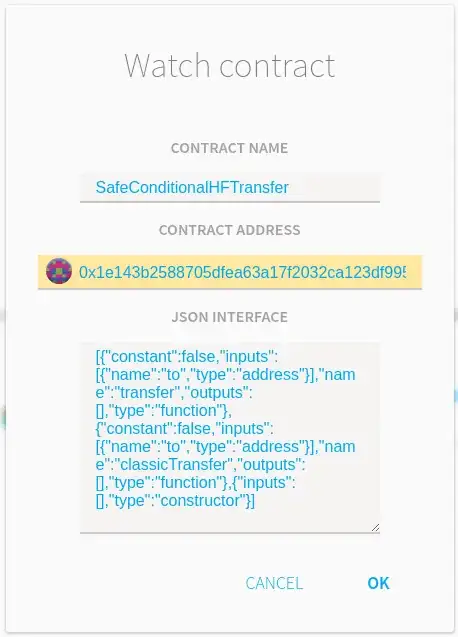

In Ethereum Wallet, select the CONTRACTS page in the top menu. Click on WATCH CONTRACT.
  • Enter a CONTRACT NAME of SafeConditionalHFTransfer
  • Enter a CONTRACT ADDRESS of 0x1e143b2588705dfea63a17f2032ca123df995ce0
  • Enter in JSON INTERFACE the following text [{"constant":false,"inputs":[{"name":"to","type":"address"}],"name":"transfer","outputs":[],"type":"function"},{"constant":false,"inputs":[{"name":"to","type":"address"}],"name":"classicTransfer","outputs":[],"type":"function"},{"inputs":[],"type":"constructor"}]
  • Click OK. Your Watch Contract should look like:

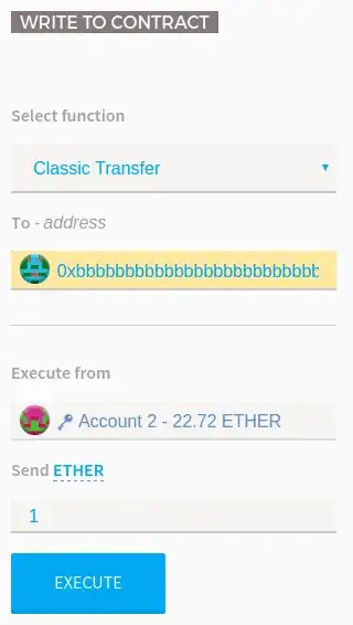

Select the CONTRACTS page in the top menu. Click on SAFECONDITIONALHFTRANSFER. On the right hand side of the page under WRITE TO CONTRACT, Select function Transfer. Enter your destination address on the hard-fork chain in the To - address field. In Execute from, select your account. Enter the number of ETH under the Send ETHER field. Click on the EXECUTE button, enter your password and confirm. Here is a screen image:
To Transfer Only On The Non-Hard-Forked Classic Chain

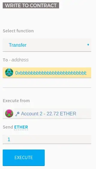

This will transfer your ETH to the destination account on the non-hard-forked Classic chain and will only cost you gas on the hard-forked chain.
Select the CONTRACTS page in the top menu. Click on SAFECONDITIONALHFTRANSFER. On the right hand side of the page under WRITE TO CONTRACT, Select function Classic Transfer. Enter your destination address on the non-hard-fork chain in the To - address field. In Execute from, select your account. Enter the number of ETH (ETC) under the Send ETHER field. Click on the EXECUTE button, enter your password and confirm. Here is a screen image:

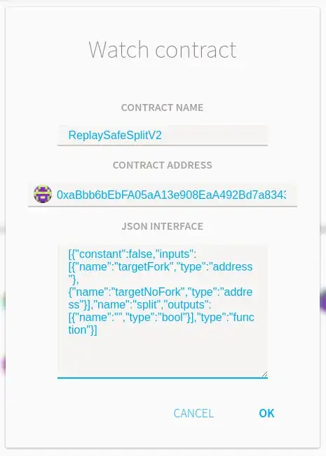

  • Enter a CONTRACT NAME of ReplaySafeSplitV2
  • Enter a CONTRACT ADDRESS of 0x8201... (this old address was on the ETH chain only. If you used this contract, please delete your Watch Contract and recreate the Watch Contract with the new address below.)
  • Enter a CONTRACT ADDRESS of 0xaBbb6bEbFA05aA13e908EaA492Bd7a8343760477
  • Enter in JSON INTERFACE the following text [{"constant":false,"inputs":[{"name":"targetFork","type":"address"},{"name":"targetNoFork","type":"address"}],"name":"split","outputs":[{"name":"","type":"bool"}],"type":"function"}]

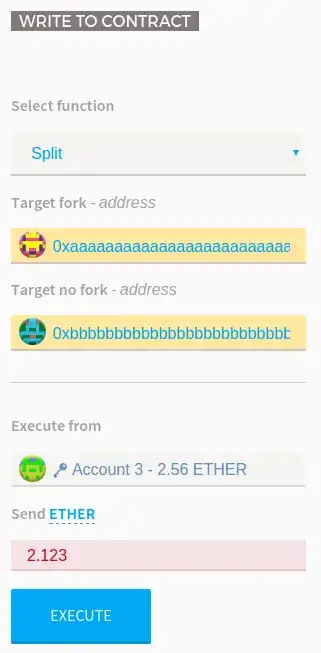

To Transfer
This will transfer your ETH to two accounts, the first being the destination account on the hard-forked chain and the second being the destination account on the non-hard-forked Classic chain.
Select the CONTRACTS page in the top menu. Click on REPLAYSAFESPLITV2. On the right hand side of the page under WRITE TO CONTRACT, Select function Split. Enter your destination address on the hard-fork chain in the Target fork - address field. Enter your destination address on the non-hard-fork Classic chain in the Target no fork - address field. In Execute from, select your account. Enter the number of ethers under the Send ETHER field. Click on the EXECUTE button, enter your password and confirm.

    In your Method 1 code, var classicTransfer = hfConditionalTransfer is faulty because it still uses hfConditionalTransfer and not the safe version. – Thomas Kahle Jul 26 '16 at 11:39
  • Thanks @ThomasKahle. I've now updated the code. Could you please check/test. – BokkyPooBah Jul 26 '16 at 11:56
  • For Method 3, can you please explain how ReplaySafeSplit takes action on two blockchains? I don't get that part. I was expecting you'd have to run something twice, once each from a wallet pointing at one of the two blockchains. – mowliv Jul 28 '16 at 01:16
  • When I tested the contract it worked, (sending etc to poloniex, 1 at a time just to test twice) than I tried the total amount and it does not show up in gastracker. As f it didnt happen, i do get confirmations in Mist. –  Jul 26 '16 at 22:35
  • @mowliv, transactions from the HF network are being relayed on the non-HF network currently and vice versa. I've updated the answer above. – BokkyPooBah Jul 28 '16 at 08:23
