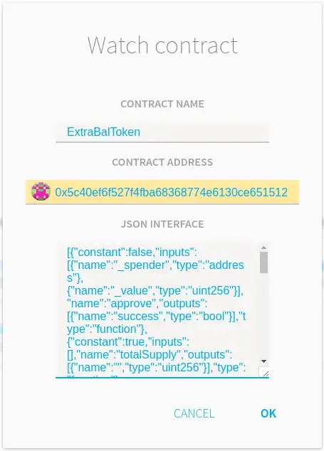

Method 2 - Step 1 - Watch ExtraBalToken Contract
In Ethereum Wallet, select the CONTRACTS page in the top menu. Click on WATCH CONTRACT.
  • Enter a CONTRACT NAME of ExtraBalToken
  • Enter a CONTRACT ADDRESS of 0x5c40ef6f527f4fba68368774e6130ce6515123f2
  • Enter in JSON INTERFACE field the following text: [{"constant":false,"inputs":[{"name":"_spender","type":"address"},{"name":"_value","type":"uint256"}],"name":"approve","outputs":[{"name":"success","type":"bool"}],"type":"function"},{"constant":true,"inputs":[],"name":"totalSupply","outputs":[{"name":"","type":"uint256"}],"type":"function"},{"constant":false,"inputs":[{"name":"_from","type":"address"},{"name":"_to","type":"address"},{"name":"_value","type":"uint256"}],"name":"transferFrom","outputs":[{"name":"success","type":"bool"}],"type":"function"},{"constant":false,"inputs":[],"name":"seal","outputs":[],"type":"function"},{"constant":true,"inputs":[{"name":"","type":"address"}],"name":"balanceOf","outputs":[{"name":"","type":"uint256"}],"type":"function"},{"constant":false,"inputs":[{"name":"data","type":"uint256[]"}],"name":"fill","outputs":[],"type":"function"},{"constant":true,"inputs":[],"name":"owner","outputs":[{"name":"","type":"address"}],"type":"function"},{"constant":false,"inputs":[{"name":"_to","type":"address"},{"name":"_value","type":"uint256"}],"name":"transfer","outputs":[],"type":"function"},{"constant":true,"inputs":[{"name":"","type":"address"},{"name":"","type":"address"}],"name":"allowance","outputs":[{"name":"","type":"uint256"}],"type":"function"},{"constant":true,"inputs":[],"name":"sealed","outputs":[{"name":"","type":"bool"}],"type":"function"},{"inputs":[],"type":"constructor"},{"anonymous":false,"inputs":[{"indexed":true,"name":"from","type":"address"},{"indexed":true,"name":"to","type":"address"},{"indexed":false,"name":"value","type":"uint256"}],"name":"Transfer","type":"event"}]
  • Click OK. Your Watch Contract should look like: enter image description here

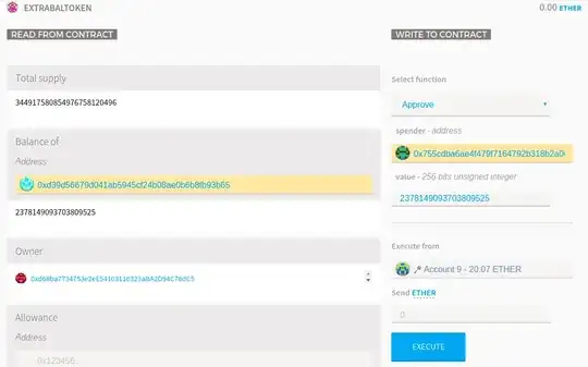

Method 2 - Step 3 - Execute ExtraBalToken.Approve
This will approve the transfer of the tokens from your account to the ExtraBalWithdrawal contract. Make sure that you send 0 ethers as this transaction may be replayed on the Ethereum Classic chain.
Select the CONTRACTS page in the top menu. Click on EXTRABALTOKEN.
  • In the Balance of field on the left hand side of the page under READ FROM CONTACT, enter your account address, ALL IN LOWERCASE. Your withdrawal balance in wei should be displayed under your address.
    • Copy this balance figure
  • On the right hand side of the page under WRITE TO CONTRACT
    • Select function Approve.
    • In spender, enter 0x755cdba6ae4f479f7164792b318b2a06c759833b, the address of the ExtraBalWithdrawal contact.
    • Copy the value in the Balance of result from the left hand side of the page and paste this figure into the value field.
    • In Execute from, select your account.
    • Enter 0 as the number of ETH under the Send ETHER field.
    • Click on the EXECUTE button, enter your password and confirm.
Here is a screen image: enter image description here

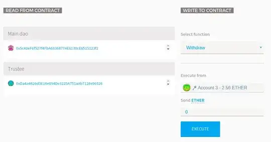

Method 2 - Step 4 - Execute ExtraBalWithdrawal.Withdraw
--- DON'T EXECUTE THIS INSTRUCTION JUST YET. The curators have not filled the extraBalWithdrawal contract and the execution will fail. This post will be updated when you are able to execute this script ---
This will withdraw ETH from the ExtraBalWithdrawal contract to your account. Make sure that you send 0 ethers as this transaction may be replayed on the Ethereum Classic chain.
Select the CONTRACTS page in the top menu. Click on EXTRABALWITHDRAWAL. On the right hand side of the page under WRITE TO CONTRACT, Select function Withdraw. In Execute from, select your account. Enter 0 as the number of ETH under the Send ETHER field. Click on the EXECUTE button, enter your password and confirm. Here is a screen image:

  • My withdraw transaction gets stuck somehow, while my approve succeeds.. EtherScan – Paul du Long Sep 09 '16 at 05:35
    @PaulduLong , the curators have not topped up the extraBalWithdraw contract yet. I'll announce it as an update in this Q&A when the curators decide to do this (or any alternate method). Just check back periodically. – BokkyPooBah Sep 09 '16 at 06:10
