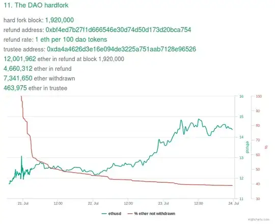

Update 18:04 Jul 23 2016 UTC
The Withdrawal contract now has a balance of 4,595,418.245476871 Ether ($65,944,251.82). About 60% of DAOs have now been converted into ETHs, over 3,887 transactions.

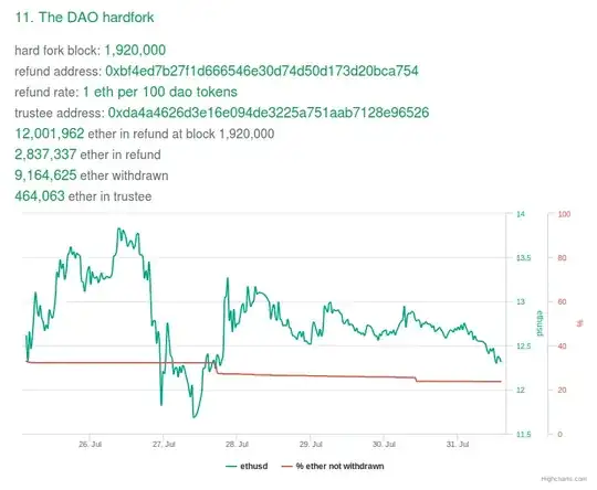

Here's a chart from https://slacknation.github.io/medium/11/11.html: enter image description here

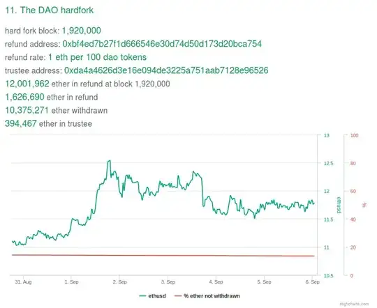

Update 14:58 Sep 6 2016 UTC
13.55% balance remaining.

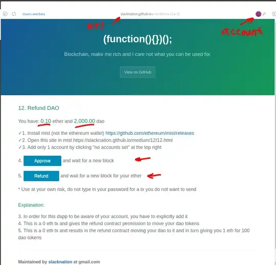

Withdrawal Method 1 - MyEtherWallet
  1. Go to http://www.myetherwallet.com/#the-dao
  2. Upload / Paste your Keystore file / Private Key to access your wallet.
  3. Press big red button.
  4. Confirm that you are sure you want to withdraw.
  5. Wait a couple seconds and 2 transaction links will appear. Wait about 30 more seconds and check the balance of your account on Etherscan. You should have more ETH and 0 DAO. I (@tayvano) confirmed it worked @ 6:43AM PDT using the MyEtherWallet donation account: http://etherscan.io/address/0x7cb57b5a97eabe94205c07890be4c1ad31e486a8

(Alternatively, you can download the Mist browser directly - see @johnmardlin answer below).
Then:
  1. Make sure you've selected only the account which you used to purchase "The DAO" tokens.
  2. In Mist browse to https://slacknation.github.io/medium/12/12.html
  3. Click on "Approve", wait for one block
  4. Click on "Refund", wait for one block
(Added Method 4 as requested by @slacknation in https://www.reddit.com/r/ethereum/comments/4tx13d/how_do_i_withdraw_dao_tokens_eth_after_hf_update/)

This is a fairly straight forward method using Mist.

  • Im following the intructions to withdraw from the latest release of the mist wallet. The problem is when i try to pick the "approve" function, my only options are "create token proxy" and "vote". Any idea why i cant use the "approve" function? Thanks – DTH Jul 20 '16 at 14:51
  • Reload your The DAO JSON interface as shown in https://daowiki.atlassian.net/wiki/display/DAO/How+to+add+and+watch+the+DAO+contract . Moderator, could you please convert the answer above to a comment. Thanks. – BokkyPooBah Jul 20 '16 at 14:53
  • I've added Method 4 - Mist in the main answer as requested in https://www.reddit.com/r/ethereum/comments/4tx13d/how_do_i_withdraw_dao_tokens_eth_after_hf_update/. Nice work! – BokkyPooBah Jul 21 '16 at 23:21
