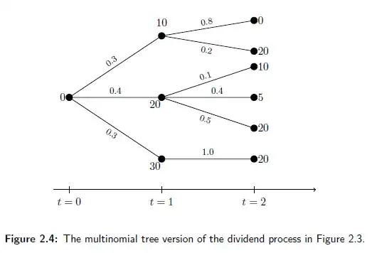

I've been meaning to post this for a long time. I came across this and thought it could add some insight. This example is from "Financial Asset Pricing Theory" by Munk.
Consider the following figure. How many assets do we need to have a complete market? enter image description here
You might think that, because there are 6 different states here, we need at least 6 different assets. In a static setting, we know that when we have $N$ different states, we must have $N$ "sufficiently different assets" (in the usual static setting, this means linearly independent). However, in the dynamic setting, this is not the case. Munk explains this based on two different observations:
(i) the uncertainty is not revealed completely at once, but little by little, and (ii) we can trade dynamically in the assets. In the example there are three possible transitions of the economy from time 0 to time 1. From our one-period analysis we know that three sufficiently different assets are enough to 'span' this uncertainty. From time 1 to time 2 there are either two, three, or one possible transitions of the economy, depending on which state the economy is in at time 1. At most, we need three sufficiently different assets to span the uncertainty over this period. In total, we can generate any dividend process if we just have access to three sufficiently different assets in both periods.
In the case of a general multinomial tree version of a more general, finite-state discrete-time market, we can for each node in the tree define the spanning number as the number of branches of the subtree leaving that node. The market is then complete if, for any node in the tree, the number of linearly independent traded assets over the following period is equal to the spanning number.
Now, in the case of a continuous-time model where the uncertainty is generated by a d-dimensional standard Brownian motion the argument is complicated, but Munk gives some insights based on the previous discussion.
The result is quite intuitive given the following observations:
  1. For contunuous changes over an instant, only means and variances matter.
  2. We can approximate the d-dimensional shock $dz_i$ by a random variable that takes on $d+1$ possible values and has the same mean and variance as $dz_t$. For example, a one-dimensional shock $dz_t$ has mean zero and variance $dt$. This is also true for a random variable $\epsilon$ which equals $\sqrt{dt}$ with a probability of $1/2$ and equals $-\sqrt{dt}$ with probability $1/2$. ...
  3. With continuous trading, we can adjust our exposure to the exogenous shocks at every instant.
Over each instant we can thus think of the model with uncertainty generated by a d-dimensional standard Brownian motion as a discrete-time model with $d+1$ states. Therefore it only takes $d+1$ sufficiently different assets to complete the market.
