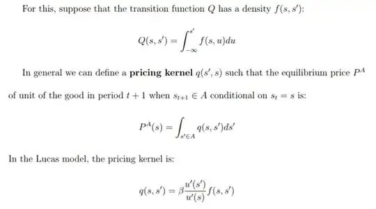

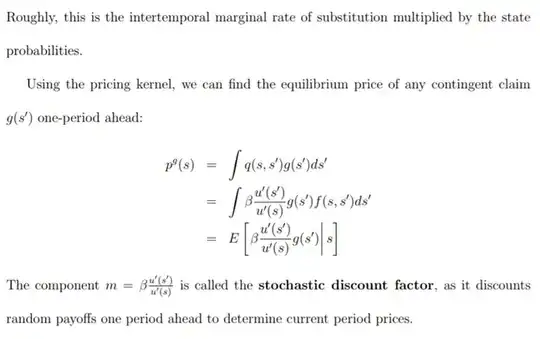

Take a look at the notes here.
We have used the equilibrium of the model to determine a single price, the price of a tree. With trading in trees, markets are complete. However we can introduce additional (redundant) assets and use the same approach to determine their prices.

The conclusion, which is in the slide titled "How many assets to complete market?", is that, in discrete time, it depends on the "branching number" (see the slides) and that, in continuous time, you can get complete markets simply with a risk-free bond and $n$ independent risky assets where $n$ is the number of independent Brownian motion underlying the economy.

If $D_t$ is the exogenous dividend process and the investor has utility function $u$, the equilibrium price is characterized by the asset pricing (Euler) equation $$ P_t = \sum_{\omega} e^{- \beta }\frac{ u'(D_{t+1})}{u'(D_t)} (\omega)) P_{t+1}(\omega) \cdot p(\omega) $$ where $\omega$ is possible state of the world that occurs at date-$t+1$ with probability $p(\omega)$. This decomposes the representative investor's portfolio---the Lucas tree---as a portfolio of Arrow-Debreu securities.
The date-$t$ price $Q(\omega')$ of the AD security whose date-$t+1$ payoff is $1_{\{ \omega = \omega' \}}$ is $$ e^{- \beta }\frac{ u'(D_{t+1})}{u'(D_t)} (\omega')) \cdot p(\omega'). $$ The Lucas tree is a portfolio whose date-$t+1$ pay-off at state $\omega$ is $P_{t+1}(\omega)$. Therefore, like any portfolio in any AD economy, its date-$t$ price is sum of $$ Q(\omega) \times P_{t+1}(\omega), $$ over all possible states $\omega$.
It is therefore clear that market is complete with respect to $\omega$-contingent claims. In principle, any investor in this economy has access to a full menu of AD securities, and any portfolio can be replicated by a portfolio of AD securities. The equilibrium AD prices/stochastic discount factor is such that the optimal portfolio for the representative investor is the Lucas tree itself.
