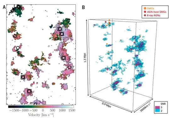

As the title suggests, can the current observational techniques detect the 3D large-scale distribution of the baryonic gas, rather than just the gas within groups or clusters?

Detecting the gas in emission is more challenging, because it is so dilute. In the vicinity of galaxy overdensities, the gas can be "lit up" by ionizing radiation from the galaxies or quasars: hydrogen is ionized, and when it recombines, it emits Lyman α. Usually more importantly, Lyman α emitted from the central sources can be scattered toward the observed.
Gas lit up in this way manifests itself as so-called Lyman α blobs, and shows you the "knot" part of the cosmic web. But recently, more filamentary structures have been observed to larger distances from the overdensities (Umehata et al. 2019). And even more recently, Bacon et al. (2021) reported on the detection of filamentary structures in more typical environments. Both of these observations were conducted using the integral field spectrograph MUSE mounted on the Very Large Telescope. This instrument gives you an image, but for each pixel, you also have a spectrum, allowing you so measure e.g. redshifts. The Bacon et al. observations required 140 hours of exposure time, highlighting the difficulties of observing something so faint.
3dweb 3D distribution of filaments, seen in Lyman α. The image itself shows you the 2D distribution, and the spectrum allows you to measure the redshift and hence distance along the line of sight, providing you with the 3rd dimension. Note though that the redshift also reflects "real" motion (i.e. not the expansion of the Universe), so the exact distance should be taken with a grain of salt. Image credit: Umehata et al. 2019.
