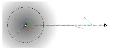

The figure below (from Laursen 2010) illustrates this phenomenon: the three photons are initially emitted in random directions, but end up traveling toward the observer on the right. On their way through the IGM, two of them are scattered out of the line of sight (LOS), and the probability of a photon from another galaxy being scattered into the LOS is negligible.
