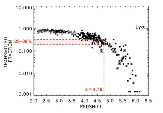

Transmission as a function of redshift
At $z=4.76$, the IGM still only transmits a few tens of percent of the continuum blueward of the Ly$\alpha$ line, as seen in this figure from Songaila (2004) (with my own annotations):
Tigm
Here the transmission is calculated as ratio between the total measured flux and an unabsorbed quasar template, in the interval 1080 Å to 1185 Å.
