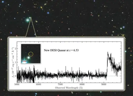

I'm not exacty sure why but Scitech Daily's Seeing Dark Energy’s True Colors: DESI Creates Largest 3D Map of the Cosmos includes the graphic and caption below.
It indicates a quasar in a Hubble image and included is an annotated spectrum from 5000 to 9800 Angstroms of a "new DESI Quasar at z = 6.53" , which shows what looks like flat noise between 5000 and 9100 Angstroms and then a sudden jump up at about 9150 Angstroms and higher.
The article talks about using DESI data to get redshifts and therefore distances, but there's no indication of how this spectrum and its pronounced feature is used to do this.
So I'd like to ask:
Question: How to interpret this spectrum of the "new DESI Quasar at z = 6.53"; what causes the big edge at about 9150 Angstroms?
A new quasar discovered using DESI gives a glimpse of the universe as it was nearly 13 billion years ago, less than a billion years after the Big Bang. This is the most distant quasar discovered with DESI to date, from a DESI very high-redshift quasar selection. The background shows this quasar and its surroundings in the DESI Legacy imaging surveys. Credit: Jinyi Yang, Steward Observatory/University of Arizona

The jump occurs at the redshifted wavelength of the Lyman-$\alpha$ line, so this is the Gunn-Peterson trough, which is caused by neutral hydrogen in the intergalactic medium suppressing any radiation with shorter wavelengths for sufficiently distant quasars.
This is a limiting case of the Lyman-$\alpha$ forest formed by the absorption lines caused by all the hydrogen clouds the light passes through on its way to us, with the absorption lines becoming so numerous due to the distance that there is no light left anymore (you could say that in this case we don't see the forest for all the trees anymore).

  • Thanks, it will be informative for me to read those links. For your Stack Exchange answer here can you address a little more "How to interpret this spectrum...?" Does the location of the edge at about 9150 Angstroms tell us $z = 6.53$? If so, how? If not, then what (if anything) can we learn from this spectrum besides "it's a quasar with $z \ge 6$? Thanks! – uhoh Jan 16 '22 at 11:02
    The peak in the spectrum is Lyman $\alpha$ emission from the quasar. At $z = 6.53$, Ly $\alpha$ (rest wavelength = 1216 Å) is redshifted to 9150 Å. – Peter Erwin Jan 16 '22 at 12:58
    @uhoh Yes, 1216*(1+6.53)=9156 Angstrom. I don't quite follow Wikipedia though that the cutoff shortward of the Ly-$\alpha$ would be due the higher density of neutral hydrogen if z>6 ( i.e. before reionization), as hydrogen clouds affecting the left part of the spectrum (5000-6000 A) would only be located around z=3. I have to think about this further. In the meanwhile you might want to have a look at https://astro.ucla.edu/~wright/Lyman-alpha-forest.html for a basic explanation of the Lyman-$\alpha$ forest (note that the spectra there are scaled back to the original wavelenghts) – Thomas Jan 16 '22 at 17:21
  • Okay I will take a look, thanks! Perhaps the assumption is that of the hydrogen between us and the quasar, it is the earliest hydrogen whose edge is most red-shifted that is associated with the long-wavelength limit of the forest. – uhoh Jan 16 '22 at 21:27
  • but I'm confused by the structure; I'm seeing an "edge" whereas some of the links talk about a peak. – uhoh Jan 16 '22 at 23:13
    @uhoh The left half of the peak (the Ly-$\alpha$ emission of the quasar) end everything shortward of it is practically chopped off by the intergalactic Ly-$\alpha$ absorption (the line width of the latter being much smaller). That's why it looks like an edge. – Thomas Jan 17 '22 at 21:53
Thomas' answer is completely correct, I'd just like to elaborate a little on the reason for such a spectrum.
Quasar spectra generally have broad emission lines, in particular Lyman $\alpha$ at a rest wavelength of $1216\,\mathrm{Å}$, originating from hydrogen being ionized by the quasar's strong UV continuum. The hydrogen quickly recombines, and roughly ~2/3 of each recombination results in the emission of a Ly$\alpha$ photon.

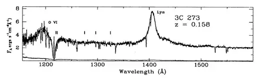

Nearby quasars
A typical spectrum of a nearby quasar (3C 273; the first ever to be identified) is seen here:
3C273 Credit: Jannuzi (1996).
3C 273 lies at a distance of 2.2 billion lightyears and consequently has a redshift of $z=0.158$, so we observe the Ly$\alpha$ emission line at $\lambda_\mathrm{obs} = (1+z)\lambda_\mathrm{em} = 1408\,\mathrm{Å}$. A broad absorption line is seen at $\lambda=1216\,\mathrm{Å}$; this features is not from the quasar, but is imposed on the spectrum by neutral hydrogen inside our Milky Way, as the light completes its final part of its journey.

The Gunn-Peterson trough
As we approach $z\sim6$, what we see is that the LAF lines eventually begin to become so numerous and overlap, that in the end all light is absorbed, as seen in this spectrum of J2315–0023:
J2315–0023 Credit: Becker et al. (2015).
Predicted by Gunn & Peterson (1965), and hence named the Gunn-Peterson trough, this effect was only observed much later (Becker et al. (2001).
In other words, the answer to your question is "The interpretation of the DESI spectrum is that it is emitted by a quasar so distant that we see it at a time when the Universe was much more dense and neutral than it is today".
