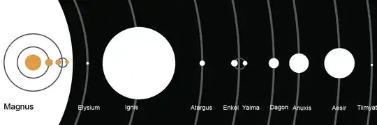

This is the ideal set up for my solar system:
EDIT
It's been pointed out that this is not a stable set up, so I want to clarify that everything in this set up can be changed at will to fit my planet. The only thing that's essential is the size, gravity and temperature of Enkei as it needs to support the fauna in my world. Yaima is intended to be a planet but can be a moon.
Magnus (Main Star):
Mass: 2.1879*(10^30)kg (1.1 Sol)
Luminosity: 5.3688798*(10^26)W (1.396 Sol)
Diameter: 1530540km (1.073 Sol)
Habital Zone: 1.13-1.63 AU
Ignis (Circumbinary Star):
Mass: 5.1714*(10^29)kg (0.26 Sol)
Luminosity: 3.4467993*(10^24)W (0.00896 Sol)
Diameter: 513400km (0.369 Sol)
Semimajor Axis: ???
Enkei (Planet):
Radius: 6923.5km (1.0865 Earth)
Mass: 5.63094*10^24kg (0.9428 Earth)
Volume: 1390160000000km^3 (1.2834 Earth)
Gravity: 7.84m/s^2 (0.8G)
Density: 4.05g/cm^3 (0.735 Earth)
Surface Temp: 292K 19°C
Semimajor axis: 260615093km 1.7421042951765742AU
Firstly, I have no idea what the most suitable orbit distance is for my binary (P-Type) Star but I found the minimum distance to be 0.11AU so 0.2 seemed a good guess. Obviously, I need a stable System before I can even begin to populate the world so this is the most important. Worst case scenario I can scrap the binary and just tweak our solar system accordingly.
