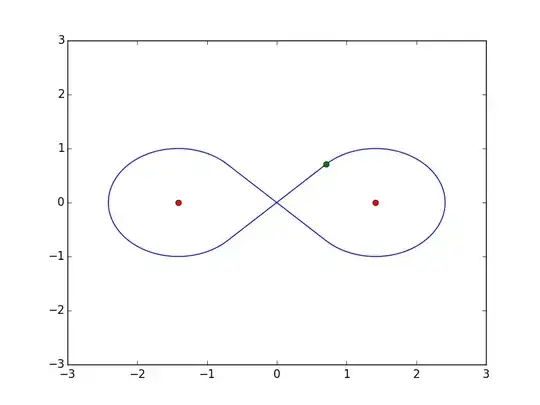

- If there's a habitable planet that orbits two suns like the above orbital route, what would possibly occur on that planet?
- Would it have two yearly seasonal cycle (compare to earth)?
- Would it be possible that there's some months where there would be no night time on every part of the planet?
- What other things resulting from the effect on day, night, and seasonal cycles can be experienced if we lived on that planet?

I'm going to attack this with math. First off, I am not going to make any assumptions about what orbits might be stable. That is something we can check with an orbit simulator like rebound, as I did in this question. Instead, I will assume there is a stable orbit around two suns of equal mass and luminosity. The orbital profile will be a perfect circle (0 eccentricity orbit) at 1 AU for 3/4 of a revolution around each sun and then a straight line connecting it to the next sun.
Determine the orbits
Since this is an ugly piecewise function, and I am solving using a computer, I am defining it in python as such:

The red dots are the two suns. The green dot is our arbitrary time = 0 for the next part; the planet starts moving clockwise around the sun on the right. So far so good, now let us calculate distance from each sun, and plot that as a function of time.

Great work for the answer @kingledion !! I would buy you a drink if you live nearby. I'm not a math whiz, but I quite understand your explanation. However I assume from your graph that this planet at 45 degrees N would have a summer that isn't as high (point) as earth but a winter just at a same lowest point? how can that happen, since when I see the model, I assume this planet would have a worst winter while suns shines all day ( when the planet in the middle of the suns). And could you elaborate more, how big is this planet compare to earth, if it takes about 730 days to complete orbit? – Hariz Rizki Dec 01 '16 at 04:28
@HarizRizki What do you mean by 'how big is this planet'? These mechanics are independent of the size of the planet. It can be any size you want. – kingledion Dec 01 '16 at 05:47
Oh okay, so the size of the planet not really matter in this equation then. Thank you. – Hariz Rizki Dec 01 '16 at 05:57
