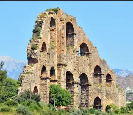

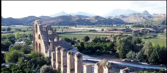

Oh! We could also use an acueduct tower.
Usually acueducts are only underground, but in the case you had a city in the middle of a big big BIG plain, there would be some possibility of having something very high.
The only way of this height happening is if the acueduct had to make a turn in the middle of the plain, where pressure would be higher.
As corners inside a pipe make a weak spot where the pipe could burst, Romans lifted the pipe to the height of atmospheric pressure in the pipe to make a turn/corner at atmospheric pressure.
Giro de acueducto1 Giro de acueducto2
The limiting facts for that are the distance of the plain, the pressure inside of the pipe and the absence of any other source of clean water (river water is not healthy).
