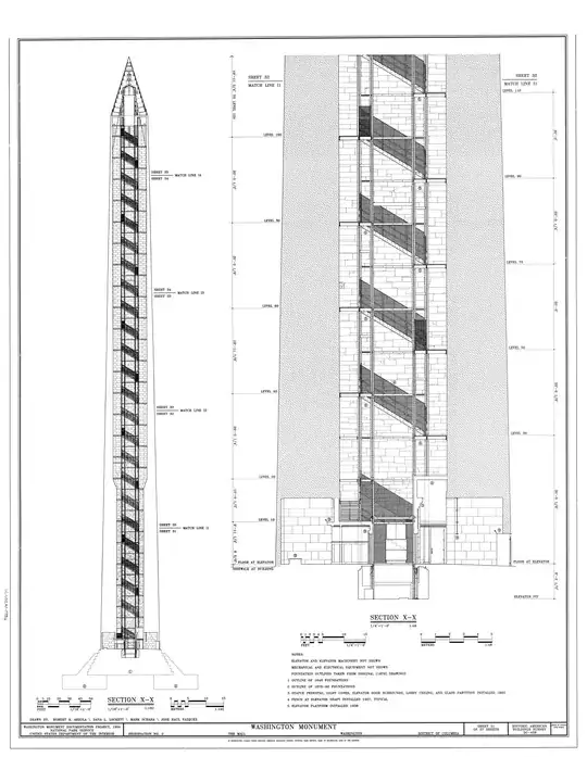

Washington Monument
The biggest hindering factor in building tall buildings is useable floor space. Elevator shafts, stairways, support structure all take away from valuable floor space available for offices. Economics was a deciding factor in many buildings and most of them are only supposed to occupy a city block.
One other limiting factor, which still is in place today, is the rope used for elevators. There's a finite length to what is useable. To go up 900m, you could not create a cable durable enough for that height. So you would need to create a series of elevator shafts to allow what height that can be achieved.
In the case of the Washington Monument, you have a building where construction started in 1848 and tops out at 555 feet tall (169m), but no floor space. The monument is filled with ironwork, consisting of its stairs, elevator columns and associated tie beams, none of which supports the weight of the stonework.
If these are not factors in your building design, then the sky is the limit.

Washington Monument Blueprint
