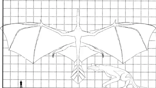

A Drawing of the dragon in question.
Height: 6.5 meters
Length: 19 meters
Volume: 11.9 cubic meters
Head/Neck Volume: 1.3 cubic meters
Average Density: 0.614 g/cm^3*
Weight: 7310 kilograms
Wingspan: 38 meters
Wing area: 304 square meters
Wing loading: 23 kg/m^2
Wings+Legs+Tail muscle cross-section: 43,000 cm^2
Muscle strength*** newtons/cm^2: 35 n/cm^2
Wings+Legs+Tail muscle strength: 1,474,900 watts
Liftoff time: 1 second
Height leaped in Liftoff**: 20.6 meters
Liftoff force on body: 2.1 gravities
Wing muscle cross-section: 21,600 cm^2
Wing muscle strength: 756,000 watts
Flap time: 2 seconds
Flap acceleration**: 21 meters a second
