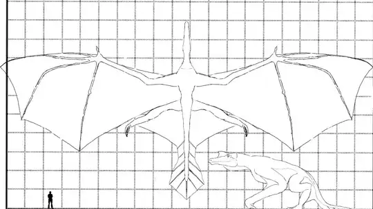

I started with a sketch of the Dragon (Updated with Structure on tail to add some stability)
Using this Drawing I treated the body as a series of ellipsoids to calculate the volume. From there I ran numbers to find an appropriate wingspan etc. and edited the images to match.
The Dragon is designed with a head modeled loosely after a false gharial, wings and a chest modeled after those of a bat for flight, and a toads legs+a kangaroos tail to aid in liftoff.
Height: 6.5 meters
Length: 19 meters
Volume: 11.9 cubic meters
Average Density: 0.614 g/cm^3*
Weight: 7310 kilograms
Wingspan: 38 meters
Wing area: 304 square meters
Wing loading: 23 kg/m^2
Wings+Legs+Tail muscle cross-section: 43,000 cm^2
Muscle strength*** newtons/cm^2: 35 n/cm^2
Wings+Legs+Tail muscle strength: 1,474,900 watts
Liftoff time: 1 second
Height leaped in Liftoff**: 20.6 meters
Wing muscle cross-section: 21,600 cm^2
Wing muscle strength: 756,000 watts
Flap time: 2 seconds
Flap acceleration**: 21 meters a second
Coefficient of lift****: =<3.9
Coefficient of drag****: =>0.12
From nasa.gov
L = (1/2) d v2 s CL
L = Lift, which must equal the airplane's weight in pounds
d = density of the air. This will change due to altitude. These values can be >found in a I.C.A.O. Standard Atmosphere Table.
v = velocity of an aircraft expressed in feet per second
s = the wing area of an aircraft in square feet
CL = Coefficient of lift , which is determined by the type of airfoil and angle >of attack.
(I'll be using metric) Density of air at 3km above sea level and -4.5c = 0.9093 kg/cm^3
0.5 x 0.9093 x 10^2 x 304 x 0.6 = 8292.816 kg of lift, more than enough to get this guy off of the ground.
Drag = Cd (d v^2)/2 x reference area
The density of air at sea level and 20c = 1.225 kg/m^3. The reference area I calculate is (1.5 x 2)m^2 for the face and torso + (36 x 0.4)m^2 for the wings, or 17.4 m^2.
0.2 x (1.225 x 10^2)/2 x 17.4 = 213.15 newtons of drag, though I am not sure how to calculate the effect of this on the dragon.
*Density of bird lowered further by certain adaptations which will be discussed in another question.
**Found using a simple work-over-time equation.
***There is no difference in strength between fast and slow twitch muscle fibers, only in contraction speed and endurance. Paper which shows this.
****Actual Coefficients of bats, if there is some reason these would not be close enough, please let me know.
I was surprised after looking at these numbers that I wasn't actually seeing anything that as far as I could tell stopped the dragon from flying. But this is my first time doing any of the math involved, and even if I got all of it right I could be missing something, so I thought I'd ask some of the smart folks over here at Stack-Exchange and see what they told me.
Assuming that this creature runs and then leaps, using arms then legs+tail, to liftoff, followed by a few flaps of its wings, could it get air-born as my numbers imply? From there could it maintain flight?
