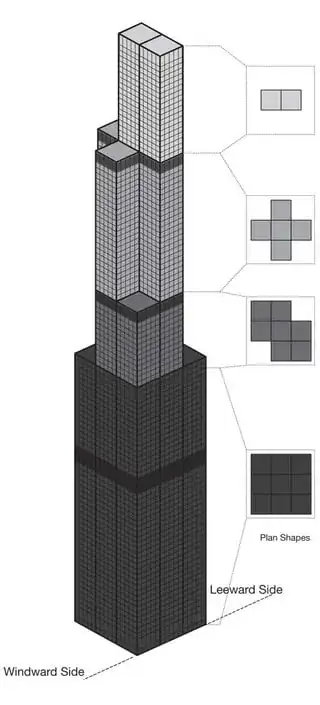

The ultimate shape of your building or its facade makes no difference. Almost all buildings are made out of a series of rectangles, no matter what they look like, and with good reason (manufacturing). Take for instance, Sears' tower.
This building style could easily produce nearly any shape. The sections would just have to end at the correct heights and be capped with, or have a facade with, the correct geometric shape.

The real hard part is properly sized HVAC systems. Sears' tower has several floors devoted entirely to mechanical systems (all those floors with no windows; the dark bands shown in the picture) which are largely populated by heating and air-conditioning systems.
