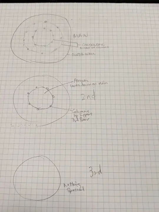

Per several requests I have added an image of what I was imagining the inside to look like.

  • How about the inside? Can you show the cross section you have in mind? – L.Dutch Aug 22 '19 at 19:37

  • Please add a picture of the desired internal structure. The exterior shape can of course be achieved, and there were actually many many buildings with this exterior shape built across the ages. It is actually called wedding cake style, and it was much favored by comrade Joseph Stalin. The problem is that without reinforced concrete the only way to achieve this shape is for the vertical walls of the upper layers to continue straight down to the foundations; they cannot be supported by the roofs of the lower layers. – AlexP Aug 23 '19 at 09:04

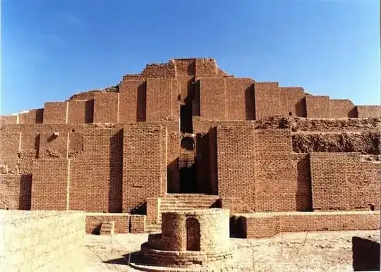

What you want is a circular ziggurat. Not any kind of ziggurat, but a hollow one with lots of internal space. That's because not all the ones built by the ancient were hollow in all layers.
Anuway, this is Chogha Zanbil. It was finished around 1250 BC:
Reminds me of my palace in Civilization
So much palaceness!

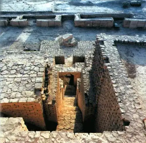

This is a view from above:
It's quite pretty from this angle
And this is an artistic rendering of it in its full glory:
Seriously I wanna play Civiliation now
If the ancient could do it, then the middle agers could too (well... Maybe, depending on where they are and the plagues they are facing). It just takes a little bit of i genuity to make the whole thing rounded.

    Aren't these build on hills and actually not-so-hollow ? having a hill would definitely make it easier, if not just feasable. – Asoub Aug 23 '19 at 08:26
    @Asoub: They are not hollow at all. Those upper layers you see? Their vertical walls continue straight down to the foundations. They are not supported by the roofs of the lower layers. – AlexP Aug 23 '19 at 08:59
  • @AlexP columns have been known since ancient times. – The Square-Cube Law Aug 23 '19 at 13:21
  • One of the defining features of the Middle Ages is that previous knowledge was lost. – chepner Aug 23 '19 at 14:06
  • The problem is they have little to no internal space and the OP wants a lot of internal space. – John Aug 25 '19 at 04:36

There is no problem with the structure you have in mind. The choir of a medieval cathedral is quite close to half your structure.
So, you will have three rings of pillars, stacked on top of each other. It's actually very close to the way things were built anyway, so just have fun, build it, and enjoy.
Mind you, your pillars will be fairly massive, since engineers at the epoch did not calculate the structures, but went by try and error. Just look at any cathedral of the epoch, and you will get a good idea how open the space on the inside will turn out.
