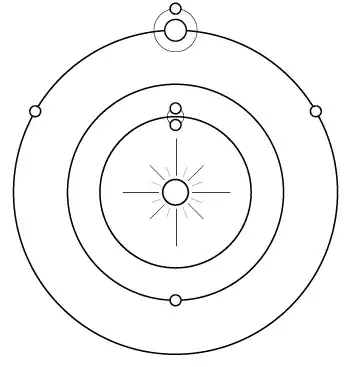

Smaller bodies at a star planet L4 and L5 are stable if the smaller bodies are 1/25 the mass (or less) of the larger planet. And 0.04 (M⊕) lies below the 0.10 (M⊕) boundary you suggest. Unless the larger planet is 4 times the mass of the earth, then it could have a Mars sized trailing as well as a leading Trojan.
Would a planet 4 times earth's mass destabilize the other planets within the habitable Goldilocks zone? Sorry, I don't know. If a super earth is possible, I could see a super earth with two Mars sized trojans as well as two other Mars sized bodies in other star centered orbits. So my guess is up to 4 Mars sized bodies and a super earth are doable within a sun like star's Goldilocks zone.
Edit: JDługosz suggested double planets are possible. I believe this is true.
So I think 6 are possible. Here's a pic:
At 1.5 A.U. is a super earth with a Mars like moon. Also at 1.5 A.U. are two Mars sized Trojans.
At 1 A.U. is a single Mars sized body. I want to keep this guy small so he doesn't destabilize the super earth trojans.
At .7 A.U. is a double planetoid, each Mars sized. This might be far enough from the 1.5 A.U. orbit that a more massive double planetoid won't destabilize the trojans.

The super earth and it's Mars sized moon needs to total a mass 25 times (or more) massive than each Trojan mass. Or else the L4 and L5 Trojans aren't in a stable orbit. – HopDavid Sep 12 '16 at 17:42

Trojans more than 1/25 mass aren't stable. Moreover a planet in a neighboring orbit orbit can destabilize Trojans. Jupiter can hold on to its Trojans because it's the big frog in our solar system swamp. So in my opinion two Trojans max. Double planets isn't a possibility I had considered through. I might edit my answer to reflect that possibility. – HopDavid Sep 12 '16 at 15:38
Ok, I reread the article. Part 4 isn’t clear on its own but in part 5 the illustrations/examples indicate 2 sharing an orbit, not 3, of equal-mass bodies. – JDługosz Sep 12 '16 at 16:44
What do you mean by "giant"? A Saturn or Jupiter would undoubtedly destabilize the lower orbits. But something 4 earth masses? Possibly, but at the moment I'm betting 4 earth masses at 1.5 A.U. wouldn't be that destructive. – HopDavid Sep 12 '16 at 17:48
