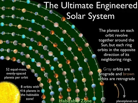

I wrote an extensive series of blog posts to answer this question: https://planetplanet.net/the-ultimate-solar-system/
Jumping to the punchline -- based on orbital stability alone it is possible to pack several hundred planets in the habitable zone of a single star (see https://planetplanet.net/2017/05/03/the-ultimate-engineered-solar-system/).
(Or a million if you incude a supermassive black hole: https://planetplanet.net/2018/06/01/the-million-earth-solar-system/)
Systems that are more likely to form naturally can easily have up to 5-10 worlds in the habitable zone.
