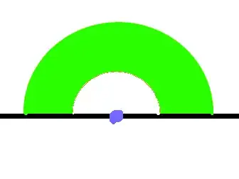

Consider a person standing on an edge of a "planet" in 2D. then, the area coloured green has an influence on you (I have made things with area have mass, in order for the concept to work in my 2D world.):
green area

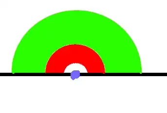

Now, consider another area with the same shape inside that one:
red area
It has just $\frac{1}{2}$ the distance, thereby four times the gravity. But it also has just $\frac{1}{4}$ of the area, and therefore a total gravitational influence similar to the green area. I can continue to stack those areas, with a sum of 1+1+1+1... Every edge then becomes a black hole!
The same argument does not hold for 3D, as half-shells have an influence of $1+\frac{1}{2}+\frac{1}{4}+\frac{1}{8}+\frac{1}{16}...$ which does not reach infinity. (You can obtain that result yourself by noticing that your skin is not made up of black holes).

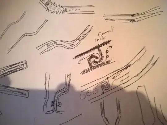

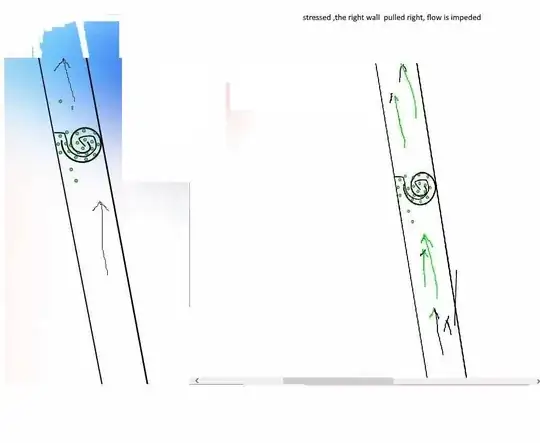

I've been working on a 2d-simulation game for well over 5 years, complete with walking, interactive, balancing bipeds in $10 m/sec^2$ accel gravity at about human scales. For your question about the stable orbits, flux would have us believe it's 1/R, as described in Dewdney's Planiverse. But if you are making this as a a game for entertainment, You could take artistic license (or come up with some string theory :) to back it, and make up a gravity law. But more importantly , other things also go along with the 1/R flux dispersion, such as sound intensity. I used 1 / squared for that. Because I don't want to walk 1 km to get away from a sound. Same with, wind drag. Same reason, or stuff even in water will never stop and it's hard to paddle your boats or swim. 2d atoms are different and you don't have to assume the Planiverse model is stepped down from our theory, much of which is made to fit what we observe. I make changes for the sake of immersion, I trust the Box2d engine, and , when you have a small monitor, even if it camera-tracks, you want dramatic motion on it. Bombs, I do $1/R^2 $
so it doesn't blow over everything .. but, the Shrapnel is 1/R. You are going to get injured and so are the others.
but hey, funny coincidence, but so happens I invented a fuel pipe just today. Devsman mentioned the transport tubes. Liquid fuelled rockets, very helpful, especially if there is no escape velocity in the 1/R gravity. Dewdney and team got some things wrong, because he didn't have a 2DWORLD simulator. As for life in 2d, well, life "finds a way" -from jurassic Park.
The zipper organs are great in biology , ( i like to invent the 2D devices but i don't think most kids who play the game even appreciate it.. they just want to blow the Ardean's heads off. I think, it, it will not leak, can be strong and or flexible ( there is no buckling in 2d) and will allow a compressed gas through, that looks like this.. Can be used with gimballed or v2-like rockets with vanes. The right side drawing has some stress pulling apart the tube, so the liquid needs high pressure then if its going to the rockets combustion chamber. In the case of gravity and other dispersive flux , I used $1/R^2$, because, well , its possible that stuff loses energy , say there is friction , dark matter, curved spaces. Funny it seems the string theorists are finding the 2+1 equations the only thing they can solve for quantum gravity, GUT, string theory ..white holes, etc...( all those holographic principle reports, i tried to read the papers but i'm clueless and I don't think many, or any people are too sure about gravity theory, in the world we can observe.
Feel free to contact me if you want to share ideas about the simulation.
[Fluid transport Planiverse][]
[More rough sketches, plenty of possibilities consider assembly, direction of stresses][]

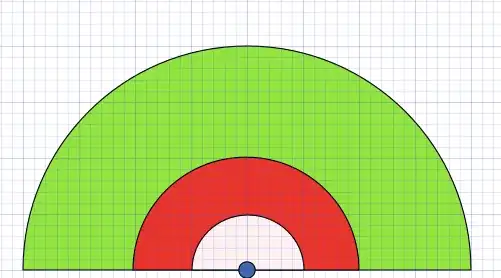

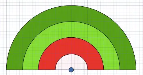

It seems to me that there is an error in your calculations of same gravity effect of concentric rings. Here I have added a grid to your picture:
The area of the green ring is $ A = 0.5 \cdot (\pi \cdot 4^2 - \pi \cdot 2^2) = 6 \pi $ and gravity $ G = \frac {\rho A}{3^2} = \frac{2}{3}\rho \pi$. For red ring, I get gravity of $ G = \frac {0.5 \cdot \rho \pi (2^2 - 1^2)}{1.5^2} = \frac{2}{3}\rho\pi$. This is the same argument as in the original question.
However, it seems to be more a rounding error, due to the way how more of the mass of the green ring is actually more distant from the center. If it is instead divided to two rings:
Then the total gravity by the green parts is: $G = \frac {0.5 \cdot \rho \pi (4^2 - 3^2)}{3.5^2} + \frac {0.5 \cdot \rho \pi (3^2 - 2^2)}{2.5^2} = \frac{24}{35}\rho\pi$ which is slightly more than the previous $\frac{2}{3}$. Not very conclusive.
Forming the actual integral, I get as the gravity in center:
$$\int_0^R \frac{2\rho\pi r}{r^2}dr = 2 \rho \pi \int_0^R \frac{1}{r} dr = 2 \rho \pi \cdot (\mathrm{ln}\,R - 1)$$
And thus there would be no more problem than in the 3D case of very thin, very dense disc. But of course it is possible that I have made error in my calculations and your original ones were correct..

    My diagram was eyeballed, but each area is intended to cover half the remaining distance towards the centre. You have made them 2/5 and 1/3 for unknown reasons – SE - stop firing the good guys Mar 04 '16 at 07:21
  • @Hohmannfan Hmm yeah, I see your point now. I updated the pictures, but the answer is not very conclusive now. Hopefully this will give someone else some ideas.. But to me it seems there should be the same problem with a thin disc in 3D world then. – jpa Mar 04 '16 at 08:00
    Nope, in 3D, if you have a constant thickness (e.g. not scale it), then that distance sooner becomes the dominant term. And with 0 thickness, the disk does not have mass in 3D, thus the problem does not exist. – SE - stop firing the good guys Mar 04 '16 at 08:12
  • @Hohmannfan Hmm, true. Though there is always a lower limit on distance, namely the distance of atoms. Otherwise there would indeed be a mini-blackhole if you had even just two atoms at inifinitesimal distance to each other. – jpa Mar 04 '16 at 08:46
  • @jpa You'd only have a mini-blackhole if your atoms were point masses, which they aren't. An atom, even a nucleus, has a radius, and two touching (or even superimposed) atoms wouldn't pack their mass into a small enough radius to form a black hole. – ckersch Mar 07 '16 at 19:23
  • @ckersch So, would that same reason solve the dilemma in 2D also? – jpa Mar 08 '16 at 05:49
