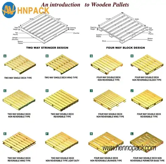

If there is one thing I'm proficient at its pallet teardown. You have lots of options. It does all depend on the style of pallet you are working with and it some cases its wood composition (hard, soft, pine, oak.....).
Pallet Styles enter image description here
For argument sake lets say you are not using the close boarded types.
Just a hammer
Some pallets rely on gravity to hold them together. Putting the pallet up on its side and hitting boards from the bottom can also work. This is truer for staple assembled boards but it can work. Also helps if there is a block of wood to absorb the direct impact and distribute the force more evenly.
