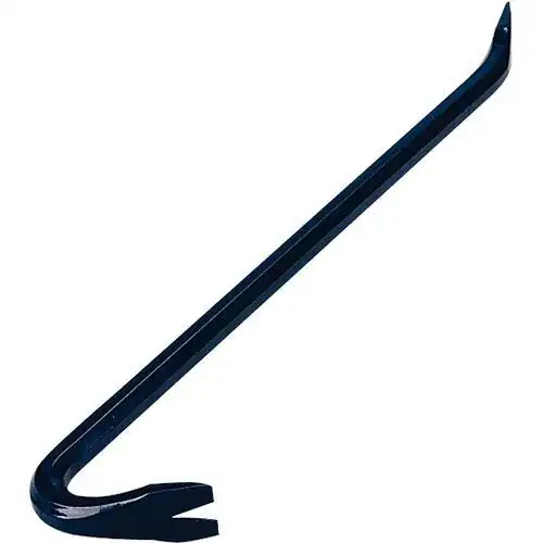

All-steel hammers and those with fibreglass handles should be immune to this problem, but the effort involved in pulling nails with a hammer is still more than you need to expend. It's better to use leverage to your advantage and use one of these instead:
These make the job a lot easier.
You will also run into the problem of nails with weak heads, or heads that have become weak due to rusting, which means they bend or break off when you try to pull them using a hammer's claws. A well-made claw hammer or wrecking bar doesn't require the head to be in place, but if you don't have one with sharp enough internal edges in the 'V' you usually have to resort to pulling some or all of the nails from some pallets using a nail puller, although you can do a surprisingly decent job with a pair of pliers.
