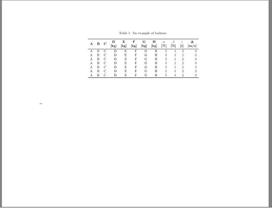

  • Your use of multirow cells are wrong. Instead them you should use thead macro defined in makecell package
  • code line with \caption had to be terminated by \\
Corrected and completed MWE is:
\documentclass[titlepage]{report}
\usepackage{geometry}
\usepackage{longtable, makecell}
\renewcommand\theadfont{\bfseries}
\usepackage{pdflscape}
\begin{document} \begin{landscape} \begin{longtable}[c]{lllrrrrrrrrr} % Set up caption and label \caption{An example of badness} \label{tab:table} \ % <--- missed % First page head \hline \thead{A} & \thead{B} & \thead{C} & \thead{D \ {[kg]}} & \thead{E \ {[kg]}} & \thead{F \ {[kg]}} & \thead{G \ {[kg]}} & \thead{H \ {[kg]}} & \thead{$\mathbf{\alpha}$ \ {[%]}} & \thead{$\mathbf{\beta}$ \ {[%]}} & \thead{$\mathbf{\gamma}$ \ {[s]}} & \thead{$\mathbf{\Delta}$ \ {[m/s]}} \ \hline \endfirsthead \caption[]{An example of badness (cont.)}\ % <--- added \hline \thead{A} & \thead{B} & \thead{C} & \thead{D \ {[kg]}} & \thead{E \ {[kg]}} & \thead{F \ {[kg]}} & \thead{G \ {[kg]}} & \thead{H \ {[kg]}} & \thead{$\mathbf{\alpha}$ \ {[%]}} & \thead{$\mathbf{\beta}$ \ {[%]}} & \thead{$\mathbf{\gamma}$ \ {[s]}} & \thead{$\mathbf{\Delta}$ \ {[m/s]}} \ \hline \endhead \multicolumn{12}{r}{\small\textit{Continued on next page}} \ \endfoot % <--- added \hline \endlastfoot % <--- added % table body A & B & C & D & E & F & G & H & I & 1 & 2 & 3 \ A & B & C & D & E & F & G & H & I & 1 & 2 & 3 \ A & B & C & D & E & F & G & H & I & 1 & 2 & 3 \ A & B & C & D & E & F & G & H & I & 1 & 2 & 3 \ A & B & C & D & E & F & G & H & I & 1 & 2 & 3 \ A & B & C & D & E & F & G & H & I & 1 & 2 & 3 \ A & B & C & D & E & F & G & H & I & 1 & 2 & 3 \ \hline \end{longtable} \end{landscape} \end{document}
If the table content is very close to the real one, table can be fit in portrait oriented pages.
Addendum: Simpler and much shorter table code with nicer result you can get with use of the tabularray package.
Edit: improved layout of table:

Zarko
  • 296,517
Just to understand what is happening: there are three problems in your document.
  1. The {=} in \multirow only works properly with p{} type columns.
  2. There should be a \\ after the \label.
  3. All the constructions of the form \\ [kg] are wrong, because the [kg] is taken as the optional argument of \\. That would be the same outside the \multirow. Either place all these inside braces {[kg]} or use \newline [kg] instead. Of course this also applies to the other units in brackets.
This is my diagnosis. I think the other solutions with makecell or tabularray are the easiest way to solve these problems (they also use the {[...]} construct).
