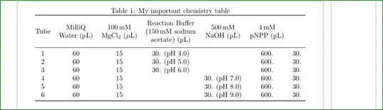

With help of package makecell and siunitx I redisign your table in form, which should be a starting point for your further effort in its formatting:
\documentclass{article}
\usepackage{booktabs,makecell}
    \renewcommand\theadfont{\normalfont}
\usepackage{siunitx}
\usepackage[margin=30mm,showframe]{geometry}
    \begin{document}
\begin{table}[h]
    \centering
\caption{My important chemistry table}
    \label{tab:table-1}
\begin{tabular}{@{}*{8}{c}@{}}
    \toprule
\thead{Tube}
    &   \thead{MilliQ\\ Water (\si{\micro L})}
        &  \thead{\SI{100}{mM}\\ MgCl\textsubscript{2} (\si{\mu L})}
            &   \thead{Reaction Buffer\\
                      (\SI{150}{mM} sodium\\
                       acetate) (\si{\micro L})}
                &   \thead{\SI{500}{mM}\\ NaOH (\si{\micro L})}
                    &   \thead{\SI{4}{mM}\\ pNPP (\si{\micro L})}  \\
    \midrule
1 & 60 & 15 & 30. (pH 4.0) & {} & 600. & 30. \\
2 & 60 & 15 & 30. (pH 5.0) & {} & 600. & 30. \\
3 & 60 & 15 & 30. (pH 6.0) & {} & 600. & 30. \\
4 & 60 & 15 & {} & 30. (pH 7.0) & 600. & 30. \\
5 & 60 & 15 & {} & 30. (pH 8.0) & 600. & 30. \\
6 & 60 & 15 & {} & 30. (pH 9.0) & 600. & 30. \\
    \bottomrule
\end{tabular}
\end{table}
    \end{document}
Option showframe of package geometry serve only for show page layout. As you can see, I manually broke long column headers. This enable macrothead frommakecell package.
Note, this only one, relatively simple solution. There are others to, for example use column type p{<width>} or use tabularx etc.
