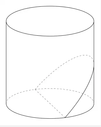

I'm trying to draw this. I would appreciate it if someone would help me to draw this.enter image description here
I put \Angle as the angle of phi, and I consider two cases \Angle from 0 to 180, and \Angle from 180 to 360. For example, with \Angle = 70

You can use like that

With \Angle = 300, my code

Or you can use
